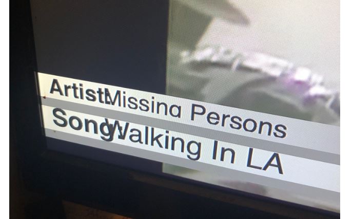

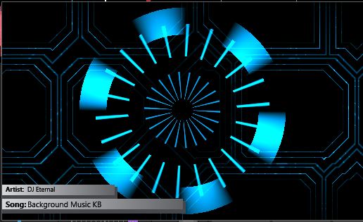

Another question, so I created a few overlays and they look fine on my setup, gave them to a friend and the positioning is off. I believe he has a mac and I have windows is it something with how mac and windows interprets them differently? We are both running at 1920x1080 resolution
This is my code and attached are my screen vs his
<textzone group="artist" align="left" deck="master" scroll="no">
<pos x="-30" y="+90"/>
<size width="1920-400" height="40"/>
<text size="45" color="#000000" weight="bold" format="Artist:"/>
</textzone>
<pos x="+85" y="+90"/>
<text size="45" color="#000000" weight="" action="get_artist_before_feat"/>
</textzone>
</textzone>
</textzone>

if you are to create a group of texts "group" is used to specify the orientation (horizontal or vertical)
no reason to try to guess the positions of the strings, the DPI may differ and give what you get - (maybe important='true' may help to keep font size coherent)
then the textzone will concat the text itself
(commented out the part not needed)
negative relative coords tend to make think your textzone is in a container.
As fonts are truncated height may be wrong font='45' in area height = 40; better use fontsize for better results, otherwhise yes mac and windows resizers can do different strange things when adapting value to make string fit.
fontsize='34' i took here is arbitrary. it depends on your font. Font will display same visual size even Dpi differ (not same size in pixel)
As a videoskin is fixed size you can position your textzone absolute and out of the container instead
the deck is always master with videoskin
standard colors can named, custom defined ones have to
<textzone group="horizontal" align="left" scroll="no">
<text fonsize="34" color="black" weight="bold" format="Artist: "/>
<!--/textzone>
<size width="1920-400" height="40"/--->
<text fontsize="34" color="black" weight="regular" action="get_artist_before_feat"/>
</textzone>

Thanks it was in a container as you suspected. I changed the size to fontsize as you recommended and also made sure my height setting is now greater then the fontsize too. I sent it over to my friend for him to test on his mac before I go changing some of the others overlays I made that had issues on his mac as well but based on the issues on the others, I'm thinking those are related to the height and text size parameters for sure since they were things like being cut off at the bottom.
