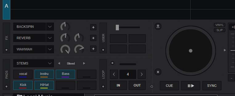

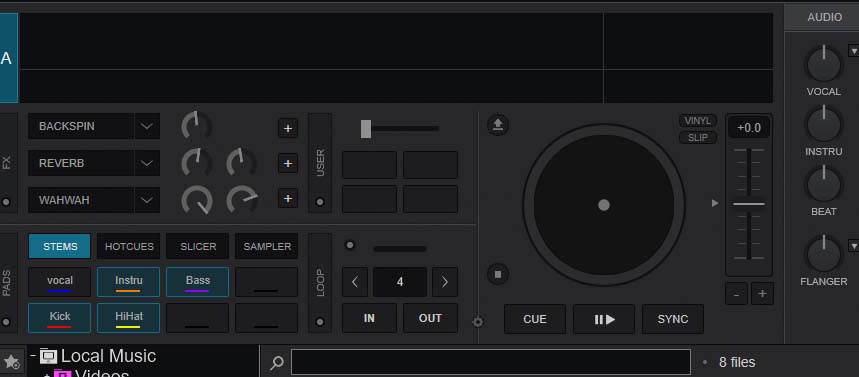

bogart wrote :
does not show bleed
The second pic you posted has a different pad layout, without that parameter area.
Posted Mon 27 Jul 20 @ 7:27 pm

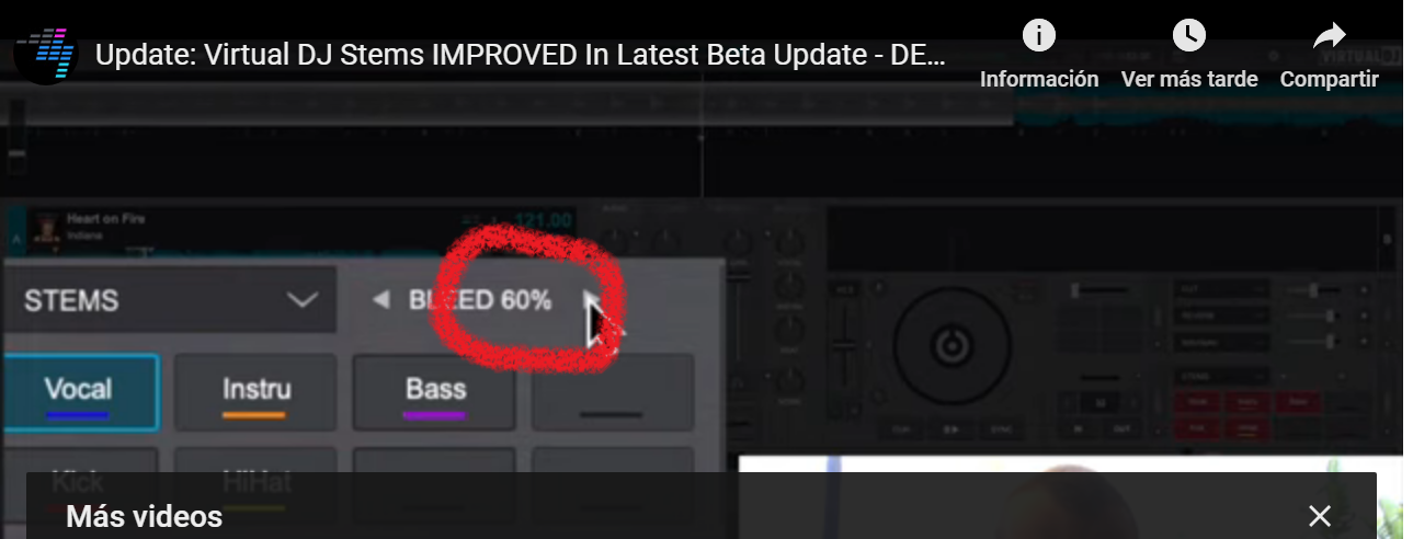

That's the way it loaded when I installed VDJ.
This is how the Bleed should look.
Posted Mon 27 Jul 20 @ 7:31 pm
