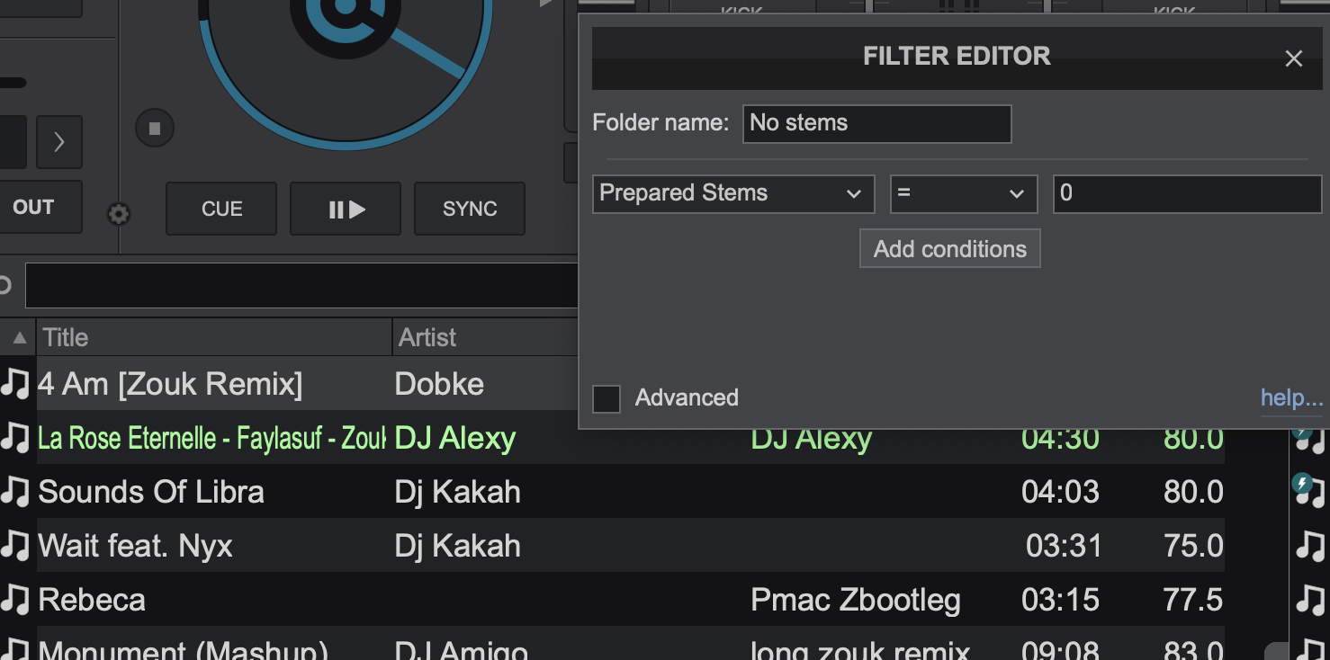

This is what I did on my side to achieve this need (filtering on files from my iTunes/Music app folder only):
Precomputed Stems = 0 and File Path contains /users/nicolas/Music/MusicLibrary/

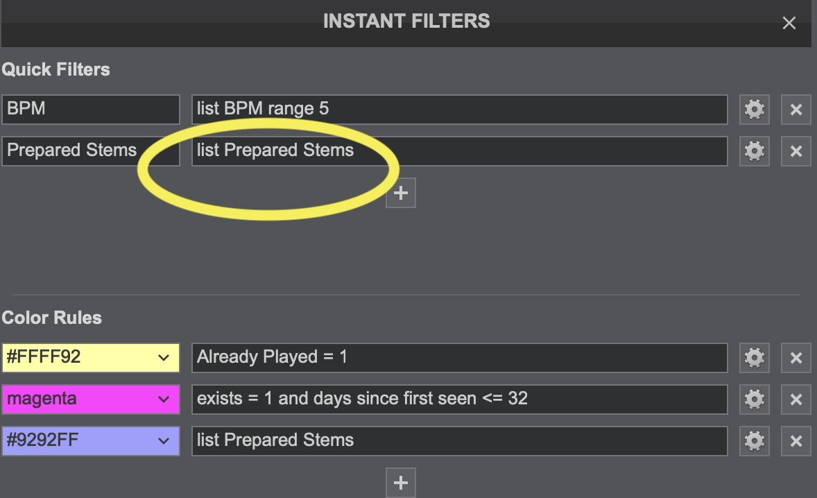

Seems you are able to do this now very simply
Posted Fri 25 Nov 22 @ 3:27 am
I found this old topic and I have question what I made wrong?
I made No Stems filter, but then I right click 'Save prepared stems' stems file is created (the *.vdjstems-file is shown in windows explorer) but the file is still shown filter folder. This file has right clik menu 'Recompute stems' and other files has right click option 'Save prepared stems'.

Sadly the browser doesn't update automatically (IKR?!)... You have to move focus to another playlist and then move back. Hopefully that fixes the issue for you!
Posted Sat 20 May 23 @ 9:46 am
I click the another filter and then click back my no stems and it was not updated.
