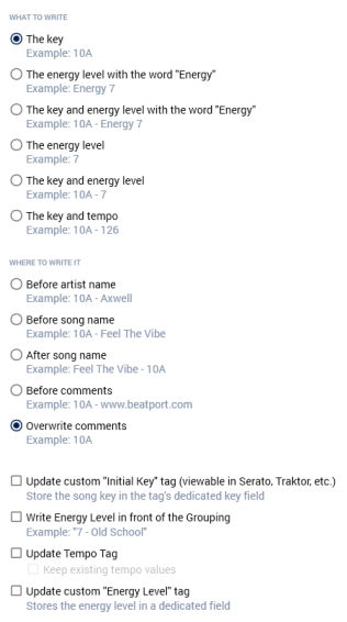

MIK has these options:
You need to write the key to the initialkey tag, not the comments.
Posted Wed 22 Jul 20 @ 9:23 am

Why are you letting VDJ convert it if you prefer MIK?
Write the keys (not to comments) using MIK, then set VDJ to get the key from the tags.

is there a tutorial on this? I tried the "use key from tag" but it's not the same key as MIK for some reason. this is part of my confusion. for example, right now im looking at songs in my folder 6 - and MIK comments are 6 (in MIK the key is also 6) and VDJ key is 6 or 5 or 2 etc... its not actually the same. would LOVE to know how to fix this
I'm going to try reanalyzing my entire library in MIK. then checking out VDJ. maybe because some songs were keyed with older versions of MIK there are issues.

Well, this seemed to work.
I reanalyzed my library and reloaded the tags.
Thanks for your patience and help :)

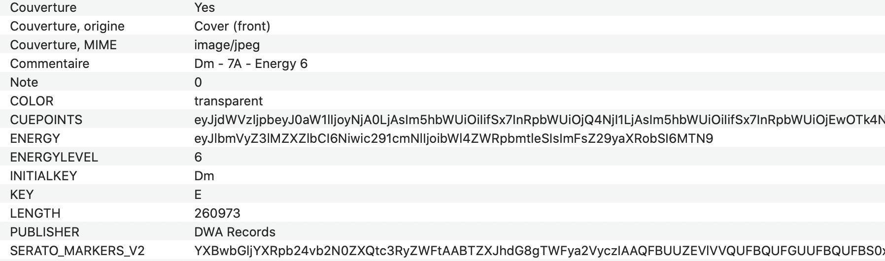

Hi,
Because MIK write the key in :
"INITIALKEY"
And VIRTUALDJ read in "KEY" TAG, not "INITIALKEY" tag used by most other DJ software, with the option useKeyFromTag option.
example with MEDIAINFO software :
Adion :
It would be nice to have in option, the choice :
useKeyFromTag from "INITIALKEY" Tag
or
useKeyFromTag from "KEY" Tag
In Rekordbox when you choose the option to write the Key on ID3 TAG, it write the KEY on "INITIALKEY" not "KEY"
Regards,
Olivier
"INITIALKEY"
Adion :
or
Regards,
Olivier
