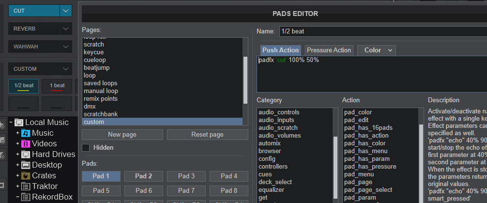

I think it's just a "cut" Effect, so you can use the Cut FX or/and create your own Custom Pads page
