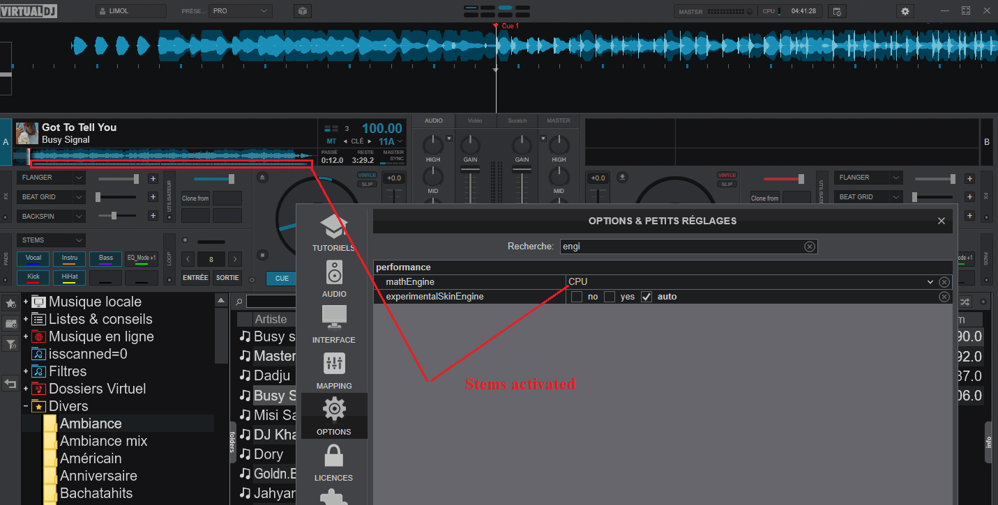

The bleed makes subtle changes to stems parameters. So you need to have the mathEngine enabled with some kind of stem removal on for it to work.
The waveforms won’t change when using bleed.

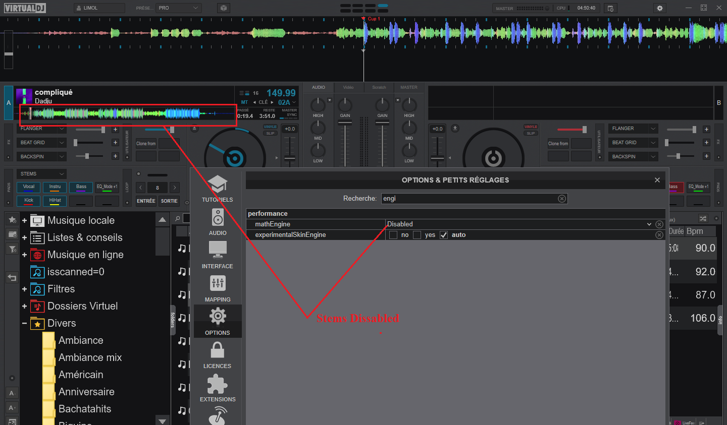

@limol I mean when the math engine is enabled...I know there is the workaround of disabling the math engine for the default type waveforms

You can enable the experimentalWaveColors option in build 6059 to combine track volume with beats display.
Posted Thu 06 Aug 20 @ 6:50 pm
Absolutely brilliant, just tested and it works a treat!
