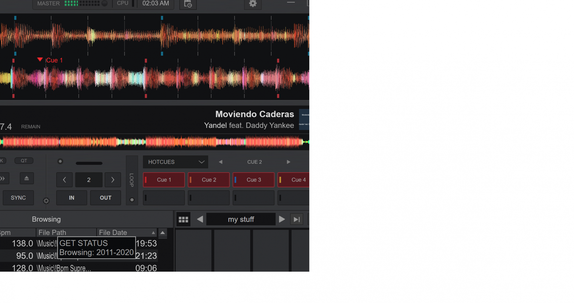

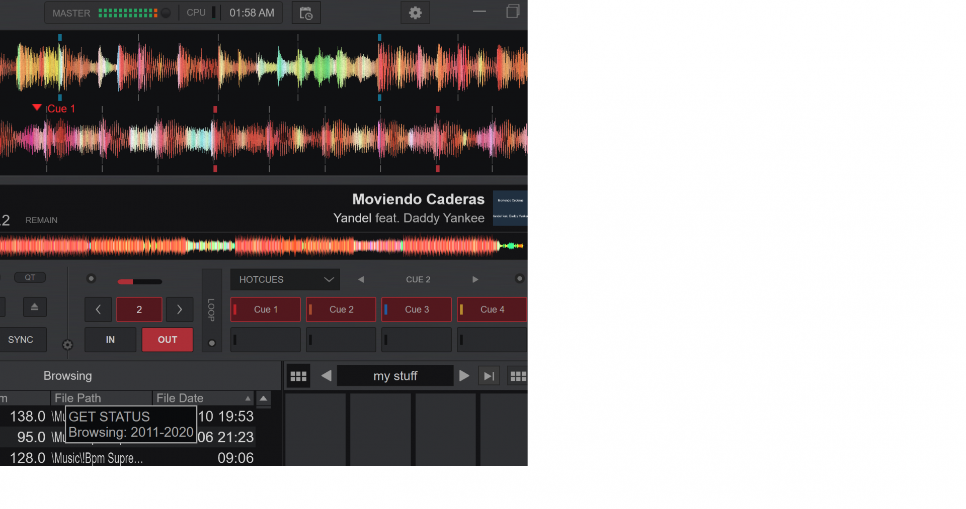

Can you check with the latest update (build 6042) what the tooltip on the 'Searching' display says while it is stuck?
Posted Sun 26 Jul 20 @ 7:07 pm
djljnitro no i never got it fixed yet..
im running latest virtual dj.. and when you slide mouse over Search..g all it says is Searching doesnt give any info

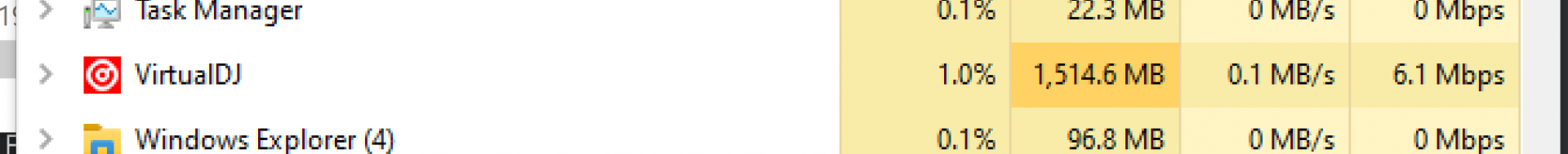

oh and check your ram how much is drawing in Task manager when it locks up for you.. i was asked to check.. just checking my emails
see if its high or so.. i will retry playing music before saturday and take screen grabs of the task manager for the ram..
but i recall a couple months ago or so it wsa only like 200 meg or something but this issues been acting up for me a couple years now.. just recently has gotten worse in the past year real bad reason i would run 2 laptops at the bar.. when main system locked up in Searching.. id flip to the backup laptop till the main returned or i had to restart vdj to get it to work again
but ya check your ram and post it to see see maybe programmers know if its drawing high ram etc

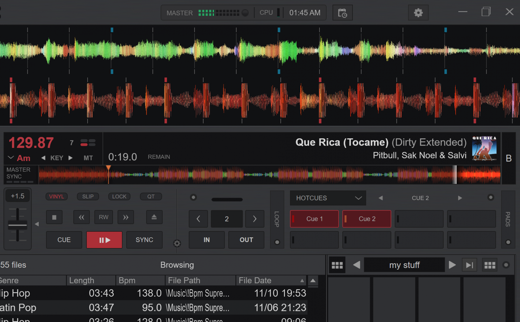

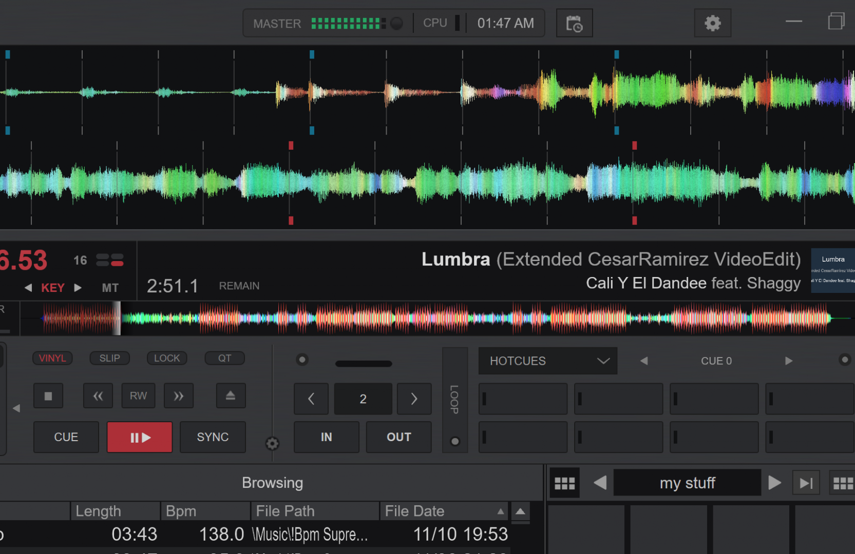

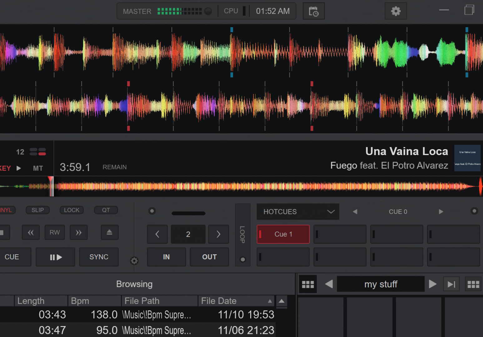

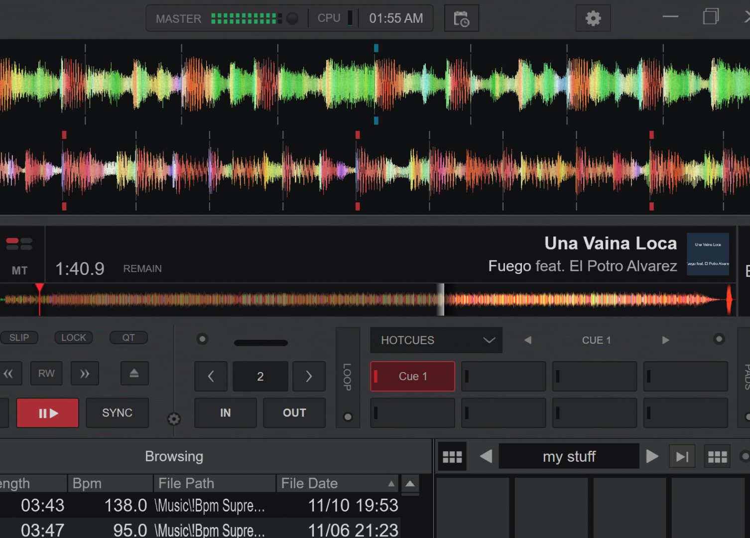

Here are screen shots from now... I am just trying to view a filter folder and it got stuck in browsing phase. It appears to be reading some of the drives at only 2 MB/s when you click on a folder. It eventually came up with the results after a while.
Edit.. I have to figure out how to attach image.

when you write there is a attach image on the right side above the SAVE
also what i been doing was using MS OneDrive to post bigger files..
but your screen shot can be with the little Picturee beside the 2 A's
