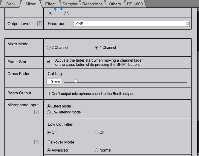

I'm really bummed out right now. I was informed on this board by Atomix personnel that there was a physical limitation built in to the DDJ-800 which prevents it from true 4 deck mixing. If you try it on VDJ, switching from deck 2 to 4 or from deck 1 to 3 and visa versa, the faders do not retain their value but switch to the value of the new deck. I have been told several times on this board that this limitation was built into the DDJ-800 by Pioneer. That always sounded fishy to me because it makes no sense. Why make a board with all the physical features to do 4 deck mixing, then when you try to perform 4 deck mixing on it, it doesn't let you do it properly? Then the excuse is, "Well that is the way it was created."
Well today I thought I would truly test this information. I loaded up Rekordbox and tried 4 deck mixing on my DDJ-800. Guess what?
NO LIMITATIONS AT ALL
When I switch from deck 1 to deck 3, the faders retain whatever value they had. The values remain separate. Matter of fact, everything in the mixer section remains separate. It is true 4 deck mixing on Rekordbox.

BINGO!!! I think I understand the entire problem now. This is what I learned using Rekordbox last night. Rekordbox's default setting is 2 Channel Mode. When it's in 2 Channel Mode you are 100% correct. It functions exactly the way VDJ functions. So I believe you when you say "...as far as we can tell the behavior was exactly the same between Rekordbox and VirtualDJ."
However, when you go into Rekordbox's preferences and enable 4 Channel Mode, everything changes. That's what I did last night. I enabled 4 Channel Mode in Rekordbox and ALL problems went away. It gave me true 4 deck mixing in every way possible. Here is a screen shot of the Rekordbox setting in preferences:
