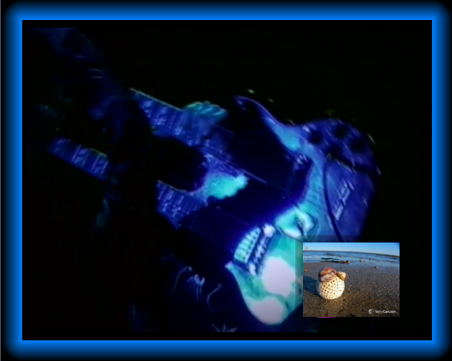

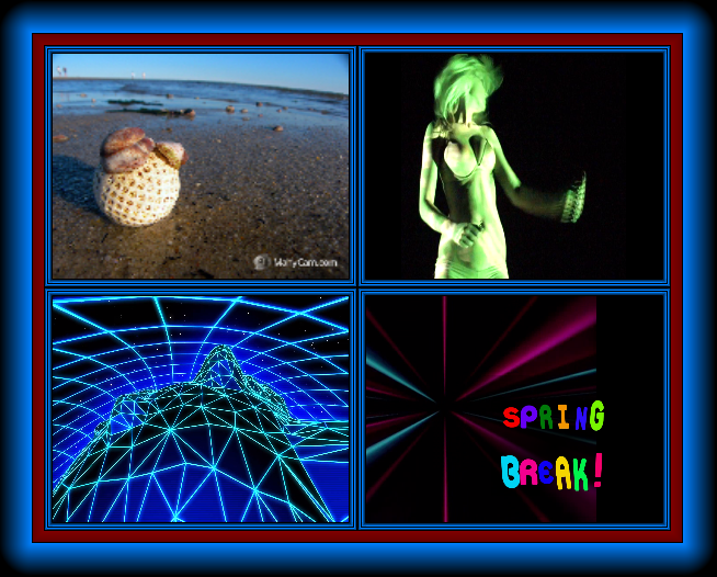

Here's a bit of an example. I still have a long way to go yet but at least I can code this up quickly now. For a long time just in my mind with nothing to look at.
In this image there is main back panel with the rounded border, another panel with red border, and 4 panels. The spring break panel is an example logo... you can display one video or image or many. The top left panel is a camera source from ManyCam. The top right is a dancing girl video. The bottom 2 are displaying video slideshows. The bottom right is in transition which I am using slide out and slide in for it. Than main back panel contains all the other panels except the logo panel.

The panels know what to do based on some event which I previously set. In this case the event was me dropping a video in. The 4 panels are rotating and resizing to nothing and what I called the logo panel is becoming the ManyCam camera image which was in the upper left. The red border is being resized to zero.
Posted Sun 29 Mar 20 @ 10:17 am
So whats left is the video I wanted to view and the logo panel which is now displaying an image from ManyCam. Panels can come an go at a click. The main back panel can be faded out which would fade out all the child panels and a new set could be faded in. I am trying to make it mac ready but there is still so much to do. When panels disappear from the screen they can be deleted behind the scenes or put into a stop state. A stop state is like a pause but it also frees up resources it does not need at the moment. They can come back quick if desired.
Posted Sun 29 Mar 20 @ 10:27 am

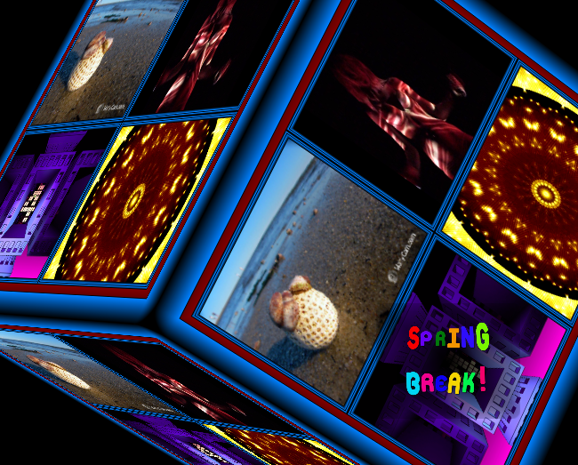

The main back panel rotated so the child panels rotate with it except for the spring break logo panel which is on top and not part of the main back panel. Some transitions include rotation, size and position, size percent, border size, border and face color, alpha, volume, reshape, etc. When changing the border color you can have it animate and glow. It has an animation language as well. I coded it up to play a high speed game of pong between 2 computer players. It used 2 panels for paddles, a clock for the ball, and kept score. I did that just to develop the language out but we will have to see how far it will go. Games like bingo should be easy.
