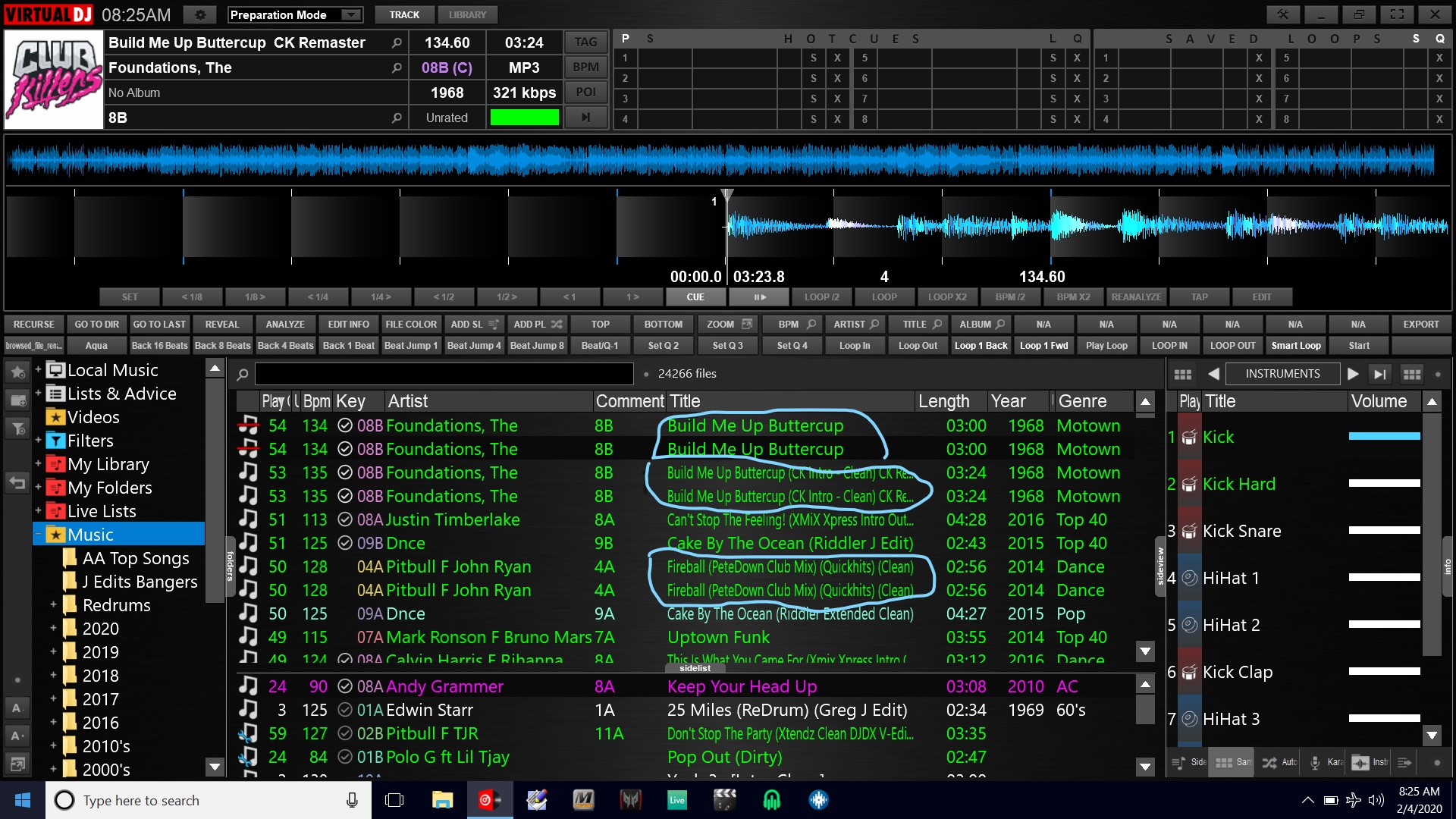

So I've been do some tag clean up (All in VDJ) and notice when I recurse my entire library (24K songs)I have several songs listed twice. They appear to the same file because when I edit them or delete them both files get updated. There is only one physical file on my hard drive.
They only show up on recurse. If I have a filter folder for top plays for instance there is only one there. Can't figure out why.
All Help is appreciated.

I have removed the database and started fresh and I still shows the same problem. It is definitely only when I recurse. it doesn't show duplicates in filter folders or in the folder where the physical file is. I deleted all the virtual folders and that didn't help either. Its driving me crazy.

They are both the exact same filepath name and size. Even when i click on open in explorer the both open to the same file. I did change the m3uafolders and that didn't work either but something clicked when you said that so....
I moved the files thru VDJ to the desktop which is a different hard drive and removed them from the search DB. I then renamed then by just adding a 1 to the end of the file. I renamed the file but NOT in VDJ. I then added them back to the hard drive with the different name then did the relocate missing file and bam there was only one file. I then put the name back to the orginal way they were and at the original location and they were all fixed. When I did correct the names I did do that in VDJ and all was good.
