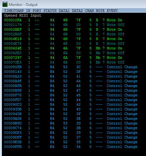

I have a Gemini PMX-20 mixer. The "factory default" controller mapping does not map all the midi controls on the mixer. I would like to add the additional mappings. I know the midi controls works as I have seen the output in Midiox. When you read the docs on custom mappings here https://www.virtualdj.com/manuals/virtualdj/settings/controllers.html#custom%20mapping item "3." mentions a "key learn feature". However, the screenshot next to it, the same way mine looks, shows nothing capable of enabling this "key learn feature".

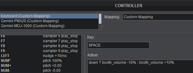

Thanks for the example action script. I understand what it is trying to do, so its very helpful.

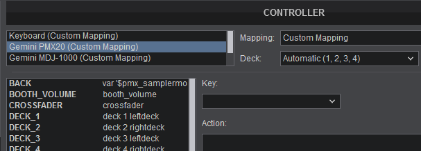

I have the BOOTH_VOLUME on the mixer mapped to booth_volume.
Just to debug things, I've noticed that I can set the keyboard SPACE to this and it works as expected:
down ? master_volume 10% : master_volume 100%
However, this does not work:
down ? booth_volume 10% : booth_volume 100%

Anorgy wrote :
.., since the booth volume on the PMX-20 doesn't have a MIDI CC,...
It has and you should get B4 51 xx values in MIDI OX when you move it.
You should also get the BOOTH_VOLUME key in the Key drop-down list when you select the Gemini PMX20.
BTW, its the one right below the MASTER, and it should give B4 51 xx not B4 52 xx i see in your MIDI OX image, unless that one was for the MIC_VOLUME (which is correct)

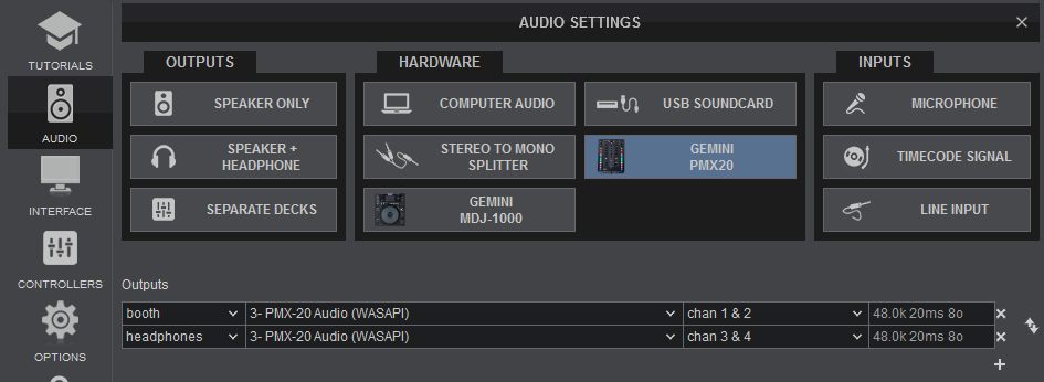

And yes, if you use an additional sound card to connect your Booth speakers, you then need to add booth in your Audio setup and ma the BOOTH_VOLUME key as booth_volume

OK. I misunderstood your earlier comments then and way overcomplicated things. It finally sunk into my head what you are saying about creating a new audio output for booth using a new sound card. Since my master audio is only going out via broadcast, I tried removing the master audio output and adding a booth audio output, along with the obvious BOOTH_VOLUME to booth_volume mapping ... and it works as desired for the keyboard SPACE, until such time as the "talk over" button gets added to the definition. WOOOOOT!
