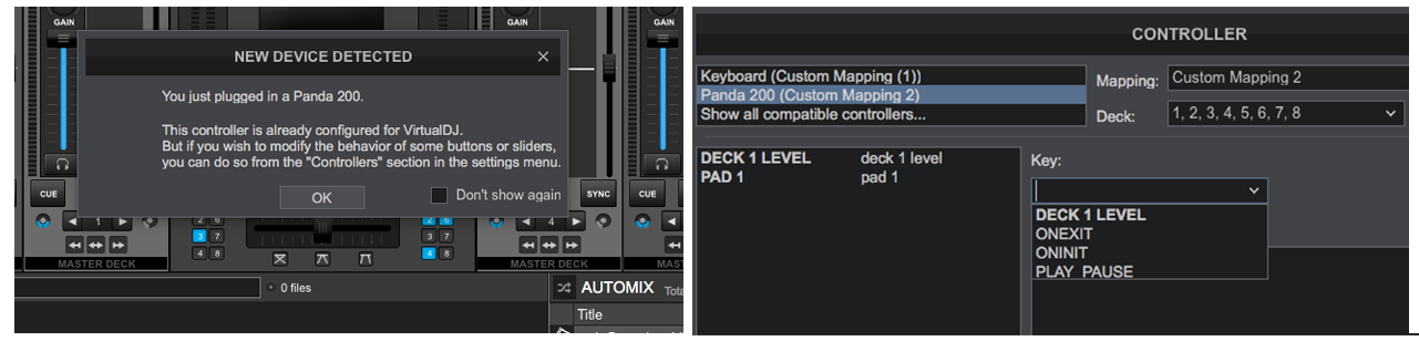

Has anyone created a device script for the Panda 200?
VDJ 8 recognizes it as simple_midi_0_0. I can map the buttons with local functions, but global functions (like using the transport buttons with 8 decks) only work on Deck 1.They don't affect the active deck (selected deck? which is the correct term?)
In contrast, I have created a device.xml file that tells VDJ the device name, product id, and vendor id -- as well as the name, description, MIDI cc location, MIDI channel of every button, slider, and knob. When I drop this device recognition file in the [myname/documents/virtualdj/devices] folder good and bad things happen.
The good thing is when i fire up VDJ it detects a new device and that I'm using it with 8-decks:
The bad thing is VDJ stops accepting any midi data from the device, and the mapper I have created is no longer available in the drop down window. So when I push the buttons or move a slider no information appears in the window on the upper right.
Once I remove my device file from the folder and start up, VDJ reverts back to recognizing it by the manufacturer name, my mapper pops up, it accepts midi data again from all the buttons, but the deck window doesn't allow global functions to map across all decks (automatic 1, 2, 3, 4, 5, 6, 7, 8)
What am i doing wrong in this device file? (let's just start with one pad, one slider, and the transport play button)

Posted Fri 27 Dec 19 @ 8:27 pm

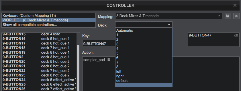

[quote=djdad]Perhaps you need a Mapping file too along with the Definition.
Thanks DjDad after being immersed in this project for this long I didn't realize you replied! My wife and kids have only seen the back of my head for many days.
I've come a long way. What I've been calling a "device script" I now know is referred to as a "definition". Talk about starting from square 1. So I created a definition file then VDJ wouldn't acknowledge any midi input... because even though the menu on the Panda says it is sending data on Midi Channel 10.. NOPE its actually using Ch 9.
Then I learned what you mean by HEXADECIMAL. Note and CC data must follow a pattern like this example (LISTEN CLOSE NOOBS LIKE ME) :
cc=0x05, 06, 07, 08, 09.0A, 0B, 0C, 0D, 0E, 0F, 10. EVEN THOUGH you set the device's output to 5 6 7 8 9 10 and so on...
Button 5 on the device is Slider5 cc=0x05 in the definition file --HOWEVER--
Button 10 on the device is Slider10 cc=0x0A
and Button 16 on the device is Slider16 cc= 0x10
Posted Thu 02 Jan 20 @ 12:25 am
