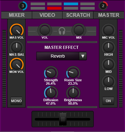

When your mic is plugged into the Platinum, it's routed directly to the output, so you can't add EQ etc to it from VDJ because the signal isn't going through the computer.
However, if you plug your mic into your computer, so the signal runs through VDJ, then you can add three band EQ, talkover etc.
Here's a mod I made to the master section of the (old) default skin...
