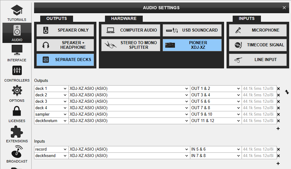

I thought that channels 1/2 were the default for the USBs and software only? Leaving channels 3/4 to be assignable.
Posted Wed 05 Feb 20 @ 10:34 am
gentle-j wrote :
Can I put the sampler on channel 3 or 4? With the DDJ Sz I could do that. I had a volume indicator for the sampler.
Sampler is by default assigned to its own output channel - that is the AUX out chans 9,10, as you can see in the default Audio setup and its Master Volume is controlled by the AUX vol knob. You could also use Mixer Channels 3 and 4 too, if you want to sacrifice a software Deck.
Mobile Zombie wrote :
Something I can't find is a DECK switch 1/3 and 2/4 as opposed to DDJ-1000. How do you control decks 3 and 4 with VDJ ?
Same as in XDJ-RX2 (and others), the Left/Right Deck switch for software Decks, is done from the Display DECK SELECT 1/3 and 2/4 buttons (offered from the SHORTCUT button). So it's a 2-steps procedure and unfortunately, there is no other way (cant be mapped to any other button to perform this - hardware layers)
FYI, we have prepared a manual for you to read further details http://www.virtualdj.com/manuals/hardware/pioneer/xdjxz.html
