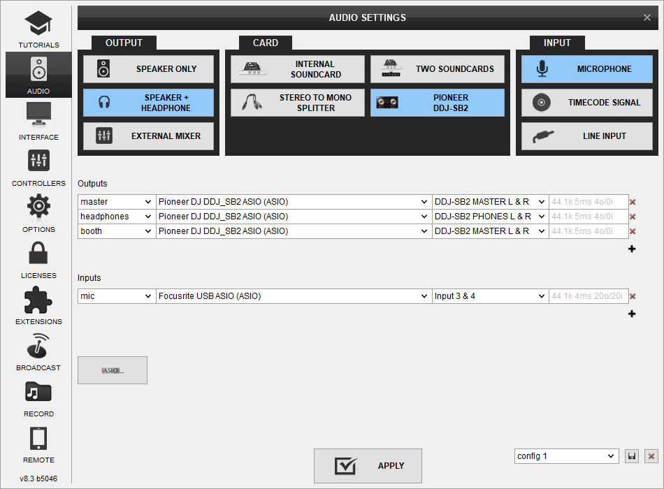

I updated to Virtual DJ 2020, build 5352 last night and in testing before I streamed live I noticed that I could hear my microphone through my main speakers.
I had avoided this in the past by adding the BOOTH option, but suddenly, now I could hear myself.
After a bunch of fiddling around, I gave up and uninstalled Virtual DJ 2020, build 5352.
I found a Virtual DJ 2018, build 5046 installer on my drive, and after reinstalling this version, everything seems to be back to normal.
I have a support ticket in, but they seem to think it's my "boothMicrophone" setting. It isn't. I could hear the microphone in the booth whether this was set to "yes" or "no.
I guess we'll see what happens.
FYI for anyone else seeing this issue.
My audio settings are attached.

You have both booth output and master output going to your main speakers. If you enable mic of course it will go to the master output and thus to your speakers.

I need the master out to go to my speakers, so I can hear my local mix, but I don't want the microphone to go to my speakers, for obvious reasons.
I need the master AND microphone to go to the stream, and recording. The settings I had, and had attached worked well until last night when I updated VDJ 2020.
Also, the "boothMicrophone" setting is not honoured in the latest version. I hear the mic in "booth" whether it's set to YES or NO.

From what I understand you only want the booth to go to your main speakers since that would not include the microphone. (depending on boothMicrophone setting)
You do want the microphone in the master output (since otherwise it wouldn't be recorded either), so you don't want the master output to go to your main speakers.

Yes - Booth to main speakers (local), and Master (including microphone) to the stream (or recording).
Current setup in VDJ 2018 works as I want:

That's a bug if it worked before, since you are asking master output to go to your main speakers.
Like I said, simply remove master output from your audio setup if you don't want master output to go to your main speakers.

Hi there,
If I remove MASTER from my output list, then I don't have an output to stream.
I still have the same issue. I tried everything you suggested, and ended up going back to Virtual DJ 2018, where it works like it should.

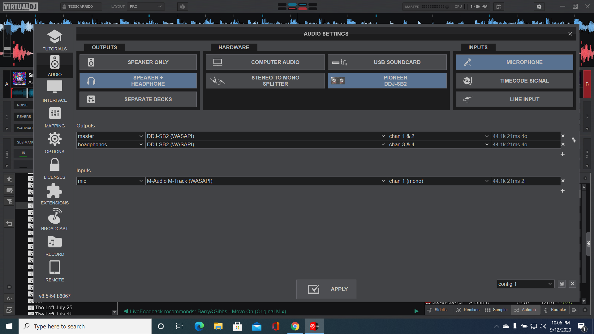

hi i have VDJ 2021 subscription , My Microphone sometimes work sometimes not , when it work i can hear my voice feed back . i tried reinstalling the driver of My M audio Track Mtrack MKII , but still same . I Have DDj sb2. this is how i set it up . I hope you can help me .
.png)
