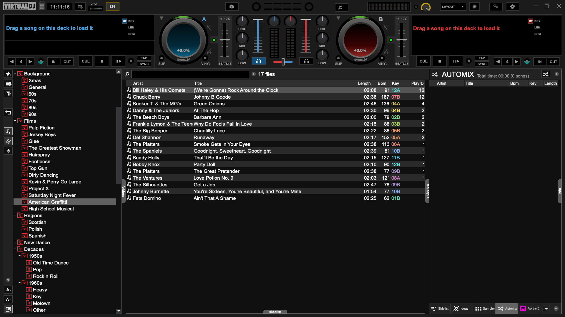

My original database was built 20 years ago and was divided into Windows folders by decade. The beauty of that was that whatever DJ software was used the tunes were in the same place.
Recently, I've been re-organising the database in VirtualDJ into Virtual Folders as you can have the same tune in several folders, yet, only one copy in your database.
Here is a screenshot of part of it.
I also create a Virtual Folder for the weddings I do with the date and the Bride & Grooms name as the title then subfolders within for the first dance, father daughter dance, playlist, etc.

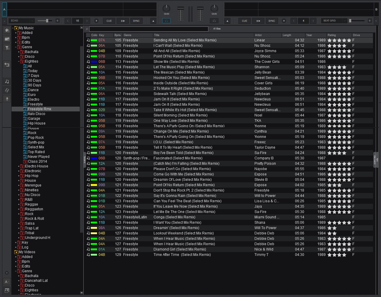

This is my external drive Windows Folder Structure. Then I fine tune with VDJ Virtual Folders and Filters.
Posted Fri 25 Oct 19 @ 7:11 pm

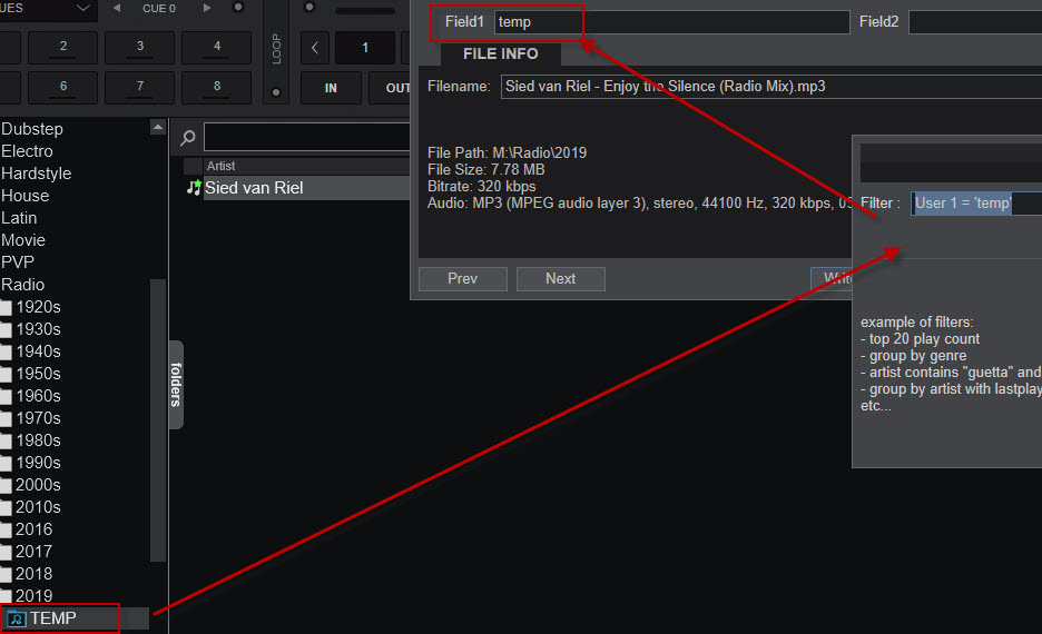

I would also recommend looking into filter folders. These allow you to set up rules using for example tags. In the case with temporary files you could use a custom tag fields and set it to "temp". Then add a filter folder with this definition:
User 1 = 'temp'
you can now simply click the filter folder and have all files with "temp" listed, for then to either delete, move them etc.
User 1 = 'temp'
