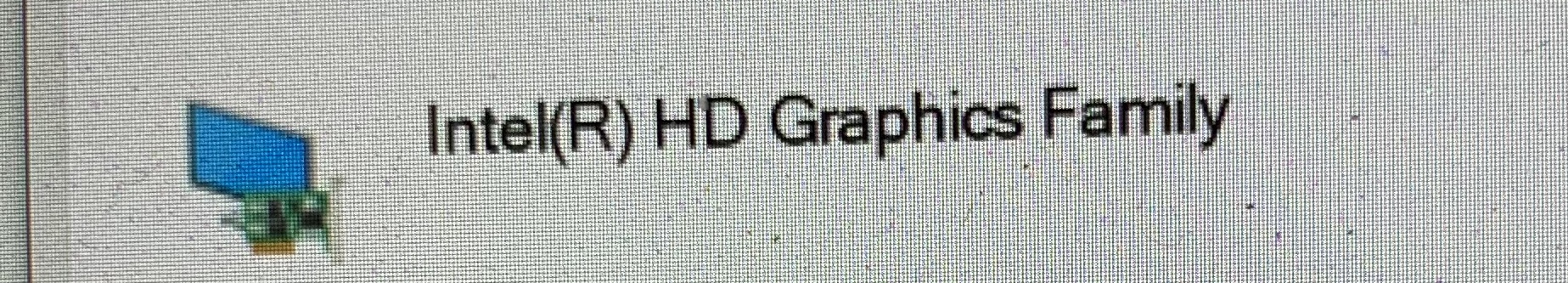

I've had this intel power saving problem on various laptops whenever most of the screen is dark.
It's possibly more noticeable with the 2020 skin since it's darker.
By installing the Intel drivers directly from Intel you can get the Intel control panel to turn it partially off, but on many laptops I've found you can not completely turn it off.
Not running full screen so that you csn have a part of bright background on the screen could help

This is the graphics card it’s in my surface pro three . I have tried everything and I’ve stopped it happening with all of the software just Virtual DJ does not want to play part .

Turn all the settings off in Windows. If you look on YouTube there are plenty of them . Also had to do some edit in the registry but this will be different depending on the device you are trying to do it on . The user that helped me above also posted a link . Which is for the surface pro four but it also worked with my surface pro three . Make sure once all the settings are applied and the registry edit is done that you restart otherwise it will not work .
Posted Mon 21 Oct 19 @ 3:20 pm
Adion wrote :
How did you fix it eventually?
Adaptive contrast is very different than auto-brightness (or adaptive brightness) found under Settings > System > Display, which ramps up and down the display backlight on ambient lighting conditions.
Adaptive contrast differs because it adjusts based on the current image on your display rather than the ambient light in your room. It's like edge-lit local dimming of specific zones due to what is on the screen. (This is also different than High Dynamic Range (HDR), which is much more sophisticated and precise with more color-depth).
This is how I did it
1 From the Start screen search for regedit.
2 Right-click it, and then and click or tap Run as administrator from the app command.
3 Computer\HKEY_LOCAL_MACHINE\SYSTEM\ControlSet001\Control\Class\{4d36e968-e325-11ce-bfc1-08002be10318}\0001
4 Scroll down to mid-page, and then find FeatureTestControl and double-click to edit the DWORD Value.
5 Change Value data from 9240 (default) to 9250 (leave in base hexadecimal).
6 Hit OK to save the changes
Restart your tablet/the computer for changes to take effect.
Hope this helps let me know if this works for you
In step five on my computer was a different value C200 and not 9240. So just change it to 9250
This will kill the feature . As Microsoft do not offer any other solution . This was also a Windows 10 computer not sure if this will work with Windows 7 as don’t have a Windows 7 machine to test .
This will not harm your system . Please be careful when working with the registry .
Posted Thu 24 Oct 19 @ 2:20 am
