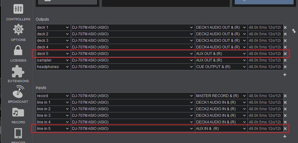

I have checked all the settings on both the VDJ pages and from the Roland DJ-707M manual...
Here is a short video of my problem >> https://youtu.be/OALWI_sEQZM
Here is a screenshot of my DJ-707M Audio settings within VDJ 2020 >> https://www.facebook.com/geniediscs/photos/a.2776116082432060/2776116455765356/?type=3&theater

I think i found something..
You are using the front "Stereo" 1/8" mini jack ? If so, you should get audio in Speakers with VDJ opened, if you set the AUX switcher to MIC position, correct ?
As far as i can see here, the sound mutes if the AUX switcher is set to MONO or STEREO. Can you confirm ?

We will add dedicated Aux Input/Output for Audio Setup in a future VDJ update, but in the meantime, you can do the following..
1. Add a "deck 5" in Outputs and route to AUX Out (same as the sampler). If you are not using a 6 Decks skin, uou wont have the "deck 5" option in the drop-down list, so just add any kind of output line from the menu and then manually type deck 5.
2. Add a "line in 5" in Inputs routed to AUX IN.
So your Audio setup will look like..
3. Goto Controllers, tab, select the DJ-707 and then change the ONINIT key from
to...
4. Assign the AUX_VOLUME knob as ..
fake_master on & fake_filter on & fake_hp on & deck all pad_page 'hotcues'
to...
fake_master on & fake_filter on & fake_hp on & deck 5 linein on & deck all pad_page 'hotcues'
deck 5 volume
Posted Fri 08 Nov 19 @ 8:45 am
