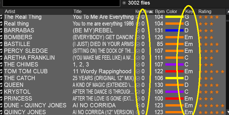

so, the key difference of zero, indicates that they are compatible, but isnt it correct to say that its not really a key difference of zero?
if one song is in a key of C and nother is in a key of G, then the key difference is 7 ? even if they are compatible

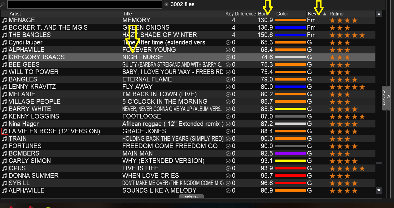

If you want desperately the same key like the playing deck ....
Follow that simple trick ....
With the playing song highlighted in the browser .... sort by BPM and then by KEY ...
VOUALA !

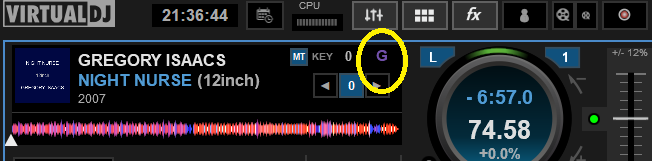

You can also use the drop-down arrow next to the KEY display on the deck.
This will show you all possibilities of going up or down, and whether this will be an exact match or just a compatible key to the other deck.
