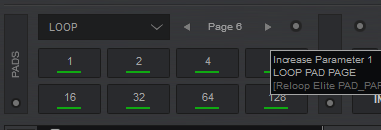

Good evening can some one explain how to switch the loops from 4bars to 16 bars on the Gemini GV2? I was advise to create a 16 bar loop by hitting the autoloop button and pressing the right bottom most cue button, but that does not enable it? Can someone assist?
Posted Fri 22 Nov 19 @ 12:12 am
Depends on which Page of the Loops Pads you are.
Use the Parameter arrow buttons on the skin (since your controller doesnt have dedicated Parameter buttons), to goto the last ones with the "big" loops.
Selected Page is remembered across sessions.
Posted Fri 22 Nov 19 @ 1:25 am
Thank you DjDad it worked.
