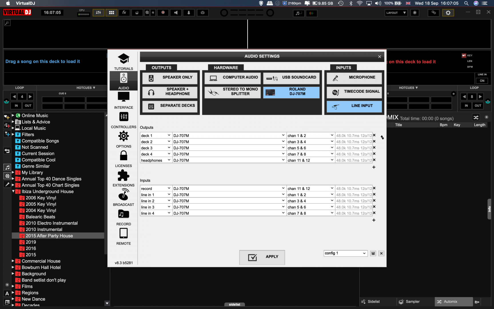

I definitely switched the source to TR and the deck to 3, the pad lights are flashing but no sound output. The volume fader is up.
My default sound settings appear to be different to the picture above.

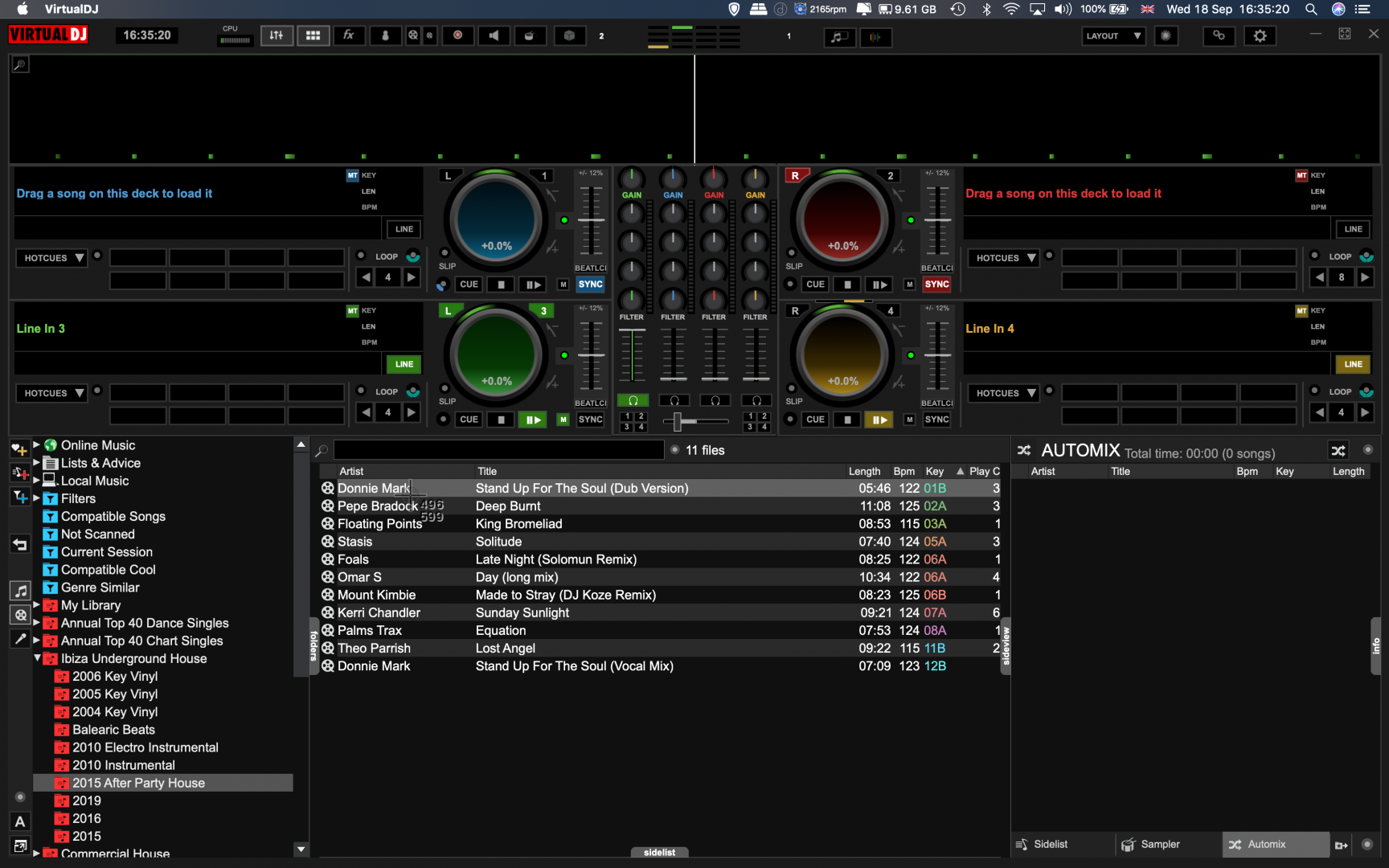

Yes your Audio setup is correct. When you switch CH3 to TR, dont you get the Deck 3 with Line In enabled ?
Have you tried with a 4 Deck skin ?

Yes the left deck 3 is showing 'Line In 3' and is playing similar to when a tune is playing. Left deck 4 is the same, but, showing 'Line In 4'.
