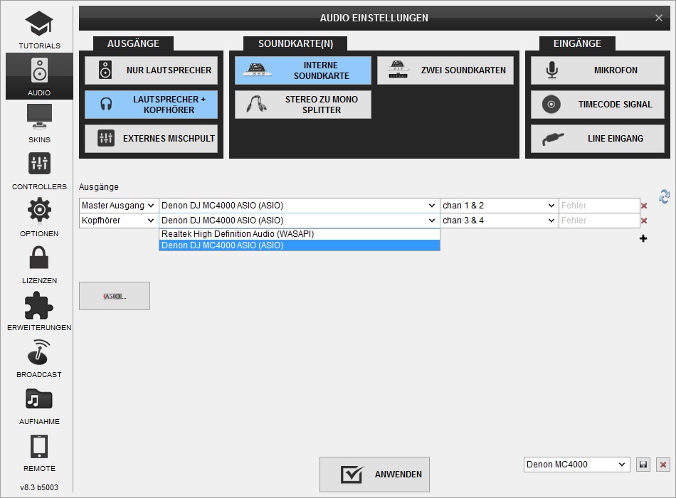

NO WASAPI, only for Realtek

Are you sure the Denon MC4000 is connected at the time you took the screenshot ?
Keep in mind that the installed ASIO drivers will show up in that list, even if the controller is not connected, but the WASAPI will be in the list only if its sound card is available/connected.

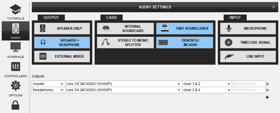

And when MC4000 is connected to a USB computer port, you dont get Denon WASAPI ?
But once again, the MC4000 is not falling into the blocked driver case, so the MC4000 ASIO driver will be available and working as before.
Yes I am sure it is conntected. Screenshot from a Win7 and without Screenshot Windows10
That is what I am saying. The MC4000 has no WASAPI but the MCX8000 has WASAPI.
But I don't want work with WASAPI.
I had never Problems!!!
Posted Wed 19 Jun 19 @ 4:02 pm

mobilbude wrote :
4 Laptops without WASAPI
No, those laptops all have WASAPI.
It's supplied by Microsoft and is built into Windows (since Vista).
