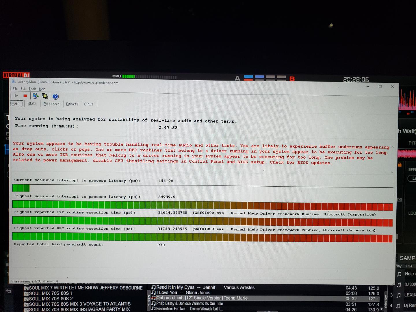

I am having a serious problem the shuttering for 1/2a second..it happened 5 times today while doing a gig ..i need help ..have tried every latency settings. I did run latency mon..and telling me something about cpu throttling that i should disable...i need help
Posted Mon 06 Dec 21 @ 4:36 am
I am having a stuttering issue after about 25 minutes of playing...it only happens if i use my dj controller as the sound card but it doesn't happen when i use my laptop sound card ..i have tried everything..i used latencymon and it told me something about computer throttling and bios and also something about a driver that is Being used ...at the end of the day I just need a solution. Please thats all I am asking what should i do to stop this stuttering..it also happens on virtual dj 2020 I don't know what to do ...please help me i am desperate
Posted Thu 09 Dec 21 @ 5:35 am

I have used latencymon and got a reading but honestly don't understand what the program is asking me to do
Posted Sat 11 Dec 21 @ 9:57 am
I am having a stuttering issue..happened 5 times at a gig last Sunday..have not played since...dod the latencymon check got the results but cant understand what to do..need some assistance
Posted Sat 11 Dec 21 @ 10:09 am
If you have a Dell, Wfd1000.sys latency issues are often caused by the Dell Support Assist program.
