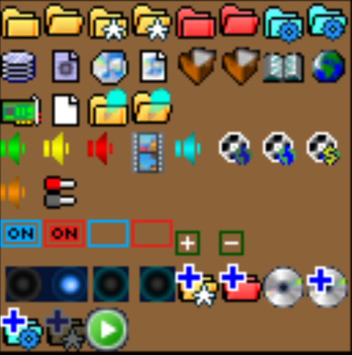

1: I switched to Shellicons Yes but still notice very little difference in the color coding. I'll try to explain a little better.
When using version 7.4 with V-mix skin, I would see my mp3 files with a Green icon, My Karaoke files were Blue, Wav Yellow . when I made a playlist for a example wedding , I would have 30 mins of music for folks gathering and I would have two BLUE karaoke songs in my playlist to signify the start of the ceremony which may run a little longer. I also did this for their entrance and first dances. I know this is trivial but it has been extremely helpful as a visual aid.
I've just loaded up V-Mix on VDJ 7.4.7 here and had a look. It seems you're referring to the small icons in the browser to the left of each listing.
Those are actually specific to that skin, as it uses custom icons.
The only way to get those exact icons in another skin is to modify the skin.
