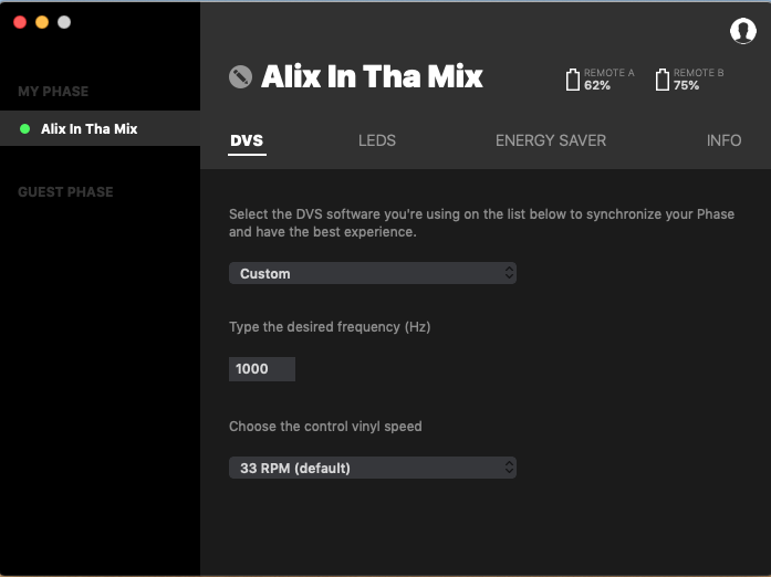

what about your audio config, i am at work so my phase and my mixer are not plugged. Send us a picture and i will compare.

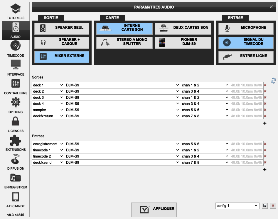

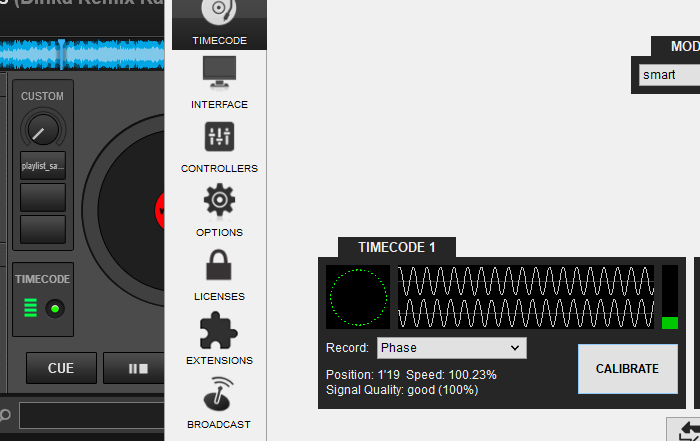

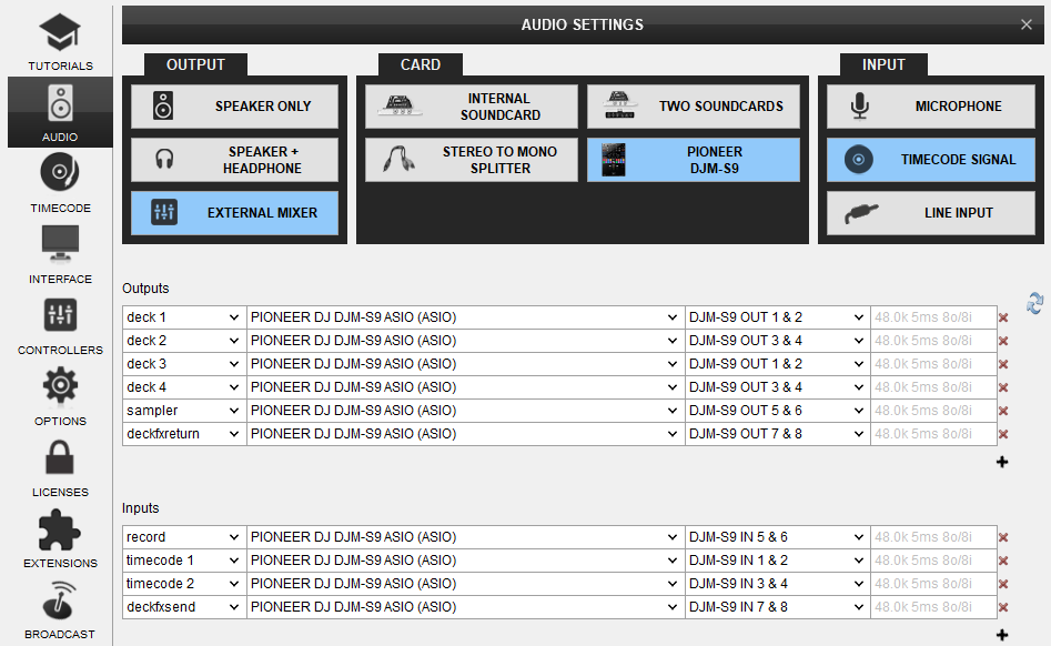

Even without the new version of Phase (MWM) Connect Configuration, which is still not updated in Microsoft Store, i get Phase working in Windows along with DJM-S9.
Connections
RCAs from Phase to DJM_S9 Line/CD Inputs
Phase USB to PC
Output connections on DJM-S9
VDJ Audio Setup is the default
Pioneer Settings:
Output Channels to CD/LINE Input
TC Signal in VDJ
Connections
Phase USB to PC
Pioneer Settings:
TC Signal in VDJ

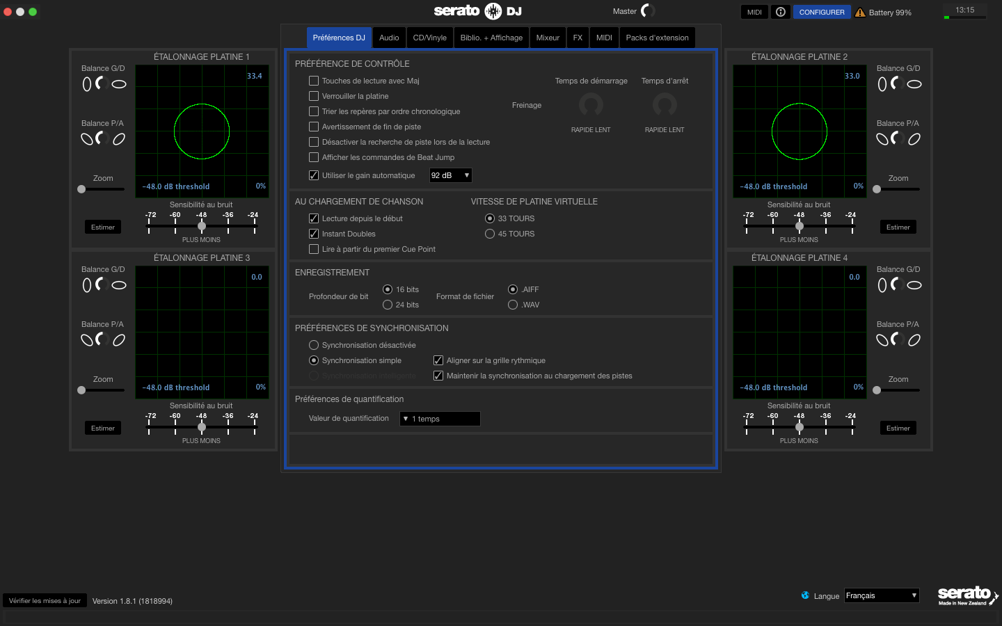

and on Sérato
i really don't understund, is there something with Mojave Os ???

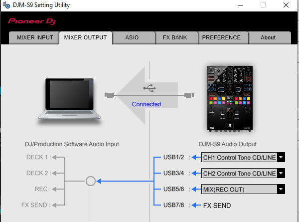

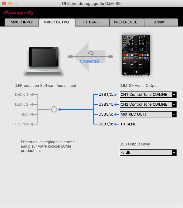

Open DJM Utilities. Set OUTPUT USB1/2 and 3/4 to Tone Control CD/LINE as per my screenshot above. Make sure your Phase outputs are connected to LINE/CD at the DJM.
I have it working on Mojave (and Windows 10) using the default Serato DVS mode from MWM Connect config.
Posted Sun 14 Apr 19 @ 12:09 pm

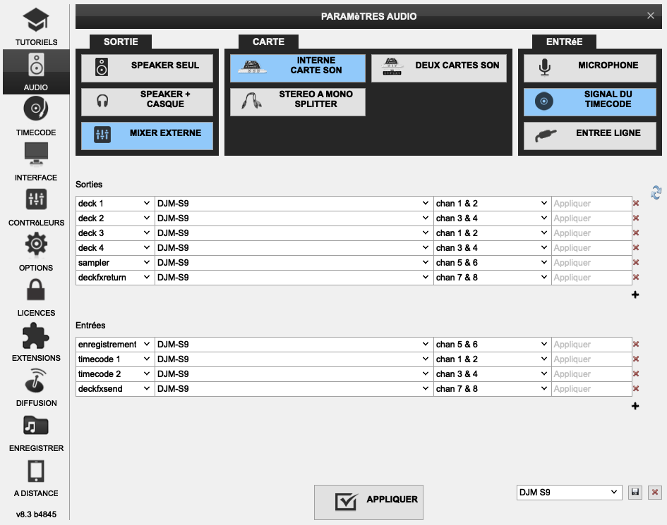

i was good since the begining, but why it works with serato and doesnt with vdj under the same mojave partition.
i noticed that even with my vinyl controle i have no signal with vdj.
I try it too on my mavericks partition and it works.
am I stuck because I installed virtual dj on my other partition?
Or did I forget to install software?

My routing is good, so i think it's a driver problem, but why does it work with serato and not with vdj?
Posted Mon 15 Apr 19 @ 2:51 pm

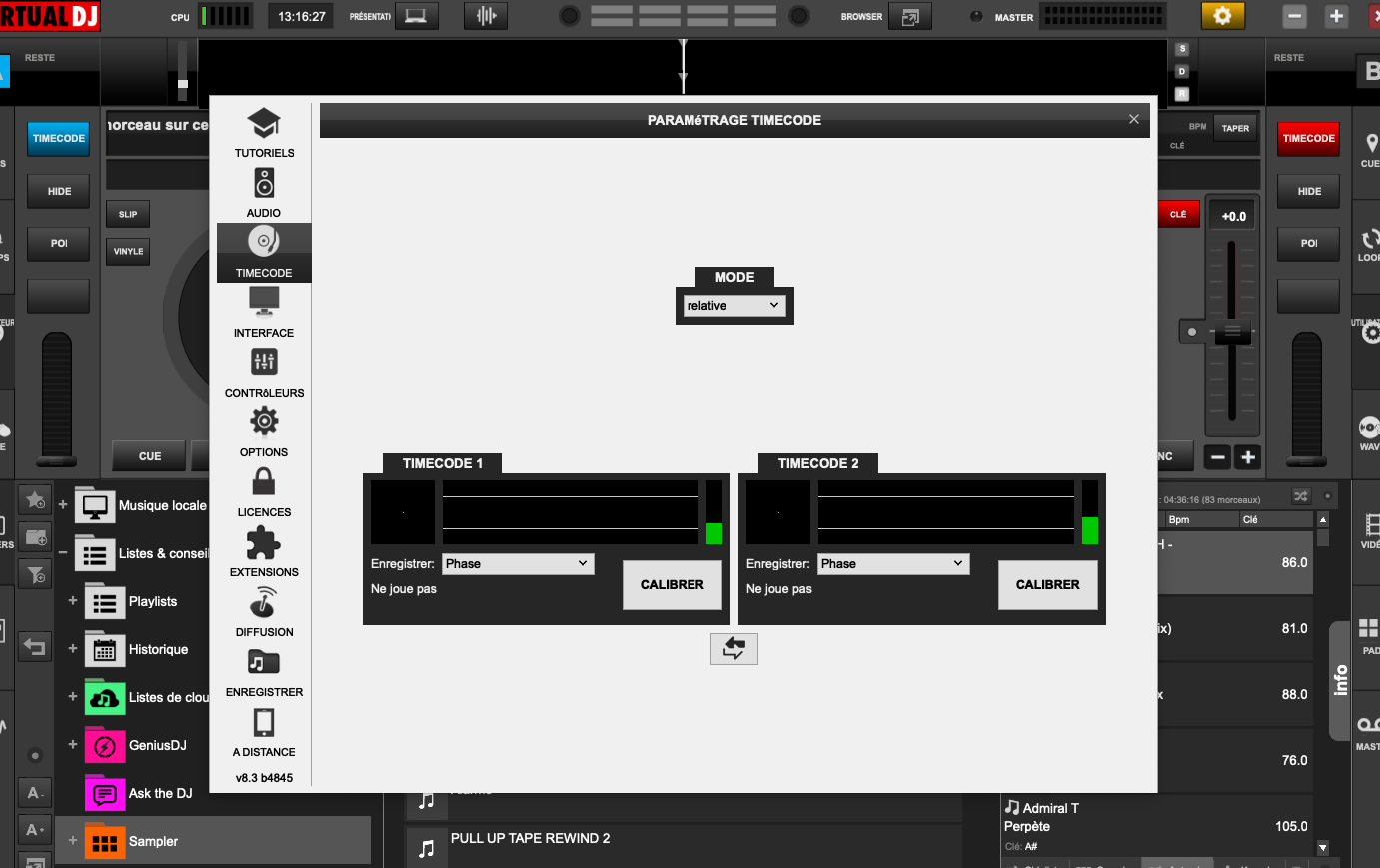

Do Phase only works with the S9? Why I can't select phase in my Dropdown in Timecode in VDJ. There is no phase? Build 4787
Posted Tue 16 Apr 19 @ 12:57 pm
Hello, I have the same Problem. I use a Native Instruments A10 Soundcard. Plugged Phase in LineInputs. No Signal in VDJ, an I can't select "phase" in the record-dropdown in timecode - config. Any Idea? Build 4787 PC (latest)
Posted Tue 16 Apr 19 @ 2:36 pm
I think you have to update your vdj version with the build 4845 avalaible for early access
Posted Tue 16 Apr 19 @ 2:41 pm
Hello, I think Build 4787 is the latest One for PC/Windows. There is no other newer version. Maybe 48.. is for Mac?
Posted Tue 16 Apr 19 @ 2:46 pm
ah sorry ... now i see .... i have to activate Early Access ... thanks
Posted Tue 16 Apr 19 @ 3:32 pm
