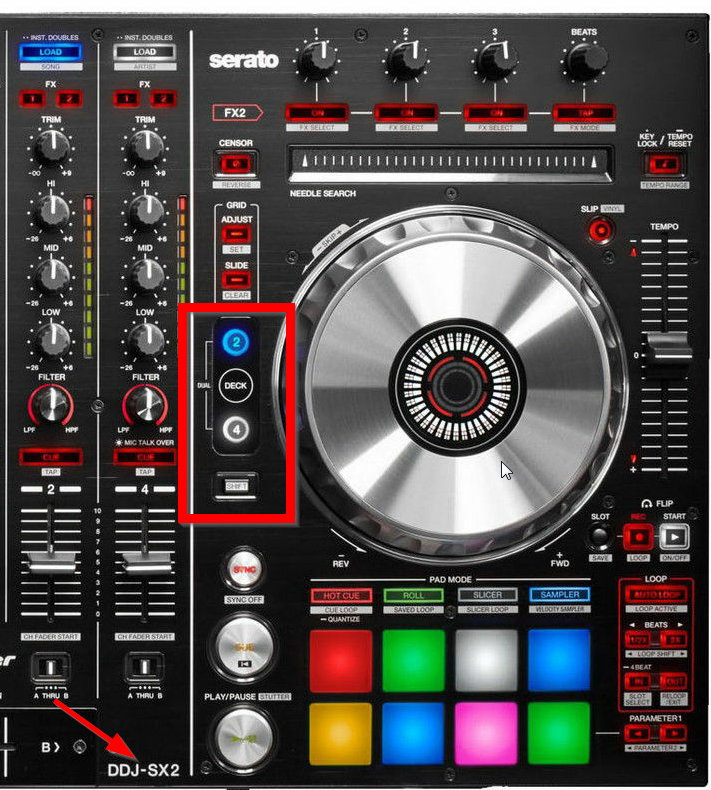

The DDJ-SX2 has no dedicated Dual Deck button : you have to click on Deck 1 & 3 buttons to enable it.
I suppose it would possible to map the same on the SZ.
Could someone please help me on mapping this function from the SX2 ?

1) Regardless of the mapper, the "Dual Deck" option for SX is firmware implemented. This means that when dual mode is active the device itself sends MIDI messages for both decks at the same time. Which means that the mapper does not need any special mapping to handle that.
In a nutshell, changing the mapping to handle dual deck operation turns a simple mapping like "play" to a much more complex mapping like: action_deck 1 ? var_equal '$DualDeckL' 1 ? deck 1 play & deck 3 play : play : action_deck 2 ? var_equal '$DualDeckR' 1 ? deck 2 play & deck 4 play : play : action_deck 3 ? var_equal '$DualDeckL' 1 ? deck 1 play & deck 3 play : play : action_deck 4 ? var_equal '$DualDeckR' 1 ? deck 2 play & deck 4 play : play

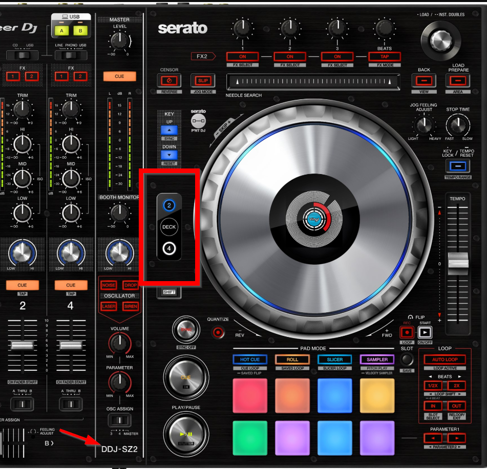

Regarding the Dual Deck function, it looks like it has never been implemented in the SZ/RZ families.
.png)
Why did they not add this feature, when they add it to th SX/RX families ??

My 2 cents. On the DDJ-SZ2 press both buttons at the same time for dual deck control. 1 and 3 on the left or 2 and 4 for the right.

It has been probably implemented on the second iteration of the DDJ-SZ.
But I have read here and there that for some DJs, it was a showstopper to buy the first SZ because Dual deck was one of the missing functions, and they went for the SZ2...
But for my part, I couldn't afford to pay for the SZ2... :(
