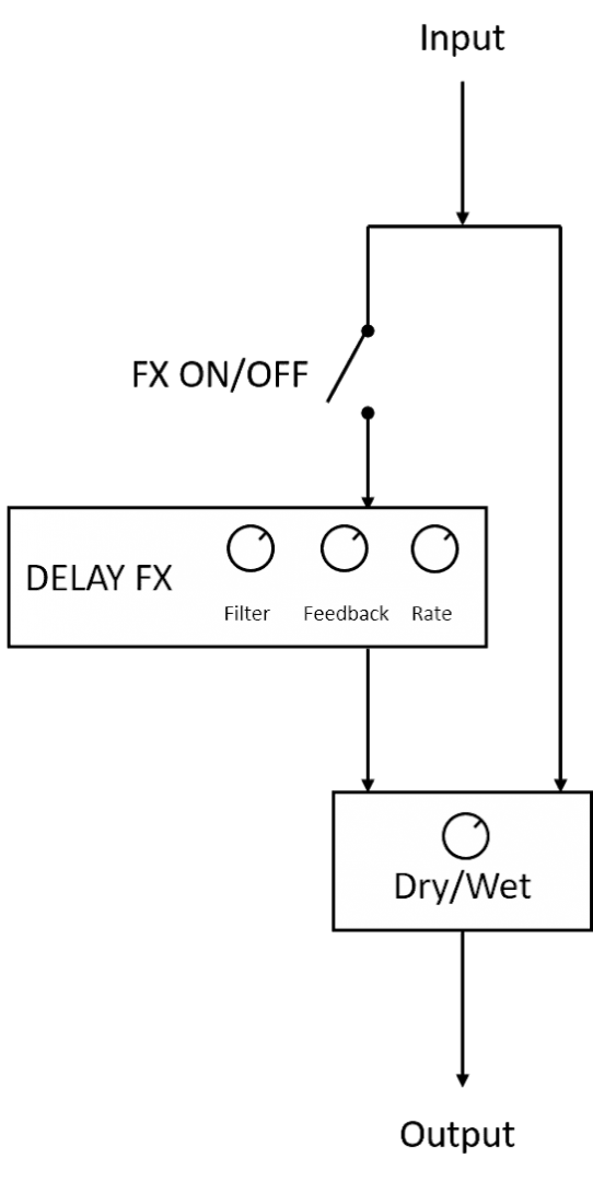

Since I'm not a paying customer, I cannot post pictures here, but here's a link to a picture showing how I'd like signal flow to be implemented in VDJ. Notice two things, one the switch which doesn't turn off FX processing, it simply cuts off the input signal, while the effect continues to process tails etc, and the wet/dry knob which is currently missing in VDJ. Using this signal flow we could use any third-party reverb and get reverb tails. Or delays, or whatever.

Thanks for posting the pic :)

Guys, post-fader FX cannot solve this problem, because what I want the FX tail to play over the track which is also playing. My proposed signal routing (see diagram) is more versatile.
I've added a second switch to my diagram for completeness, so that, when needed, the FX tail can be interrupted abruptly as well.

That's like a parallel effect or similar to a parallel compression.
Parallel compression, also known as New York compression, is a dynamic range compression technique used in sound recording and mixing. Parallel compression, a form of upward compression, is achieved by mixing an unprocessed 'dry', or lightly compressed signal with a heavily compressed version of the same signal.
In some VSTs, it's not just a dry/mix (meaning how much you want of the effect, but it actually really mixes in both signals, the dry and how much of the wet signal together). It'll make the signal louder, but I guess that would be the added effect.

Yes, it's parallel processing indeed, and this is how it works in Traktor. The results are very good because you can blend FX more subtly rather than fully on/off. More importantly, you can cut off the input to the FX while so it processes the tail while the source material continues to play via the parallel path. That's how you get the tail and the source track to play alongside each other. VST reverb plugins don't have this kind of signal routing built in because the routing is usually handled by the DAW, not the plugin; likewise, VDJ should, ideally, be able to take care of such basic signal routing.
