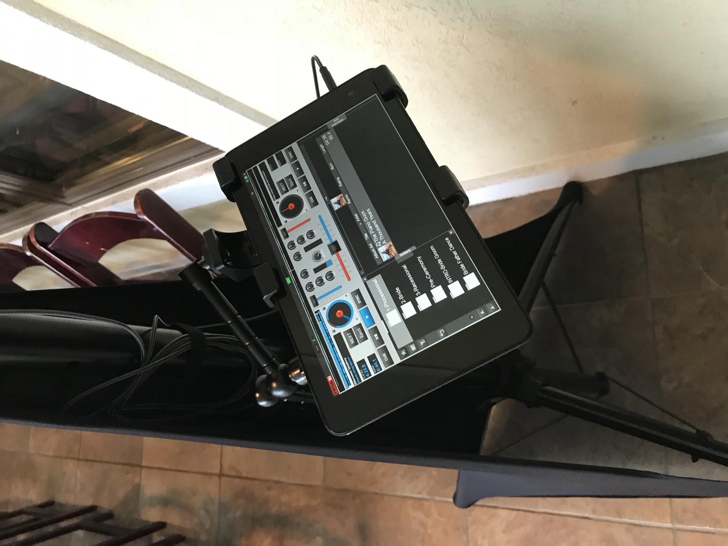

Is there a way to attach the VDJScript to the pads? I see under the custom pads in the default skin i can click on a custom pad and assign the script. I would like to have larger buttons onscreen that i can press on my tablet, as im using this without a controller or external device. Trying to be as portable as possible for my ceremony system. This is running on a 8" windows 10 tablet:-) Thanks for all your help!!

Yes, you are correct in how you do it
Whether you can then see and execute the pads in the GUI is up to your skin
IMO: You need to use a skin with a pad section
