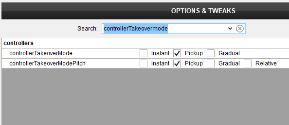

after reading through all this maybe the setting you want to adjust is -> controllerTakeovermode
Try the instant setting.

Personally I'd prefer the Gain controls to be set to instant, as the knob range is small and very sensitive, it can be tricky to "pick up" the gain without making a noticeable level adjustment in the process.
