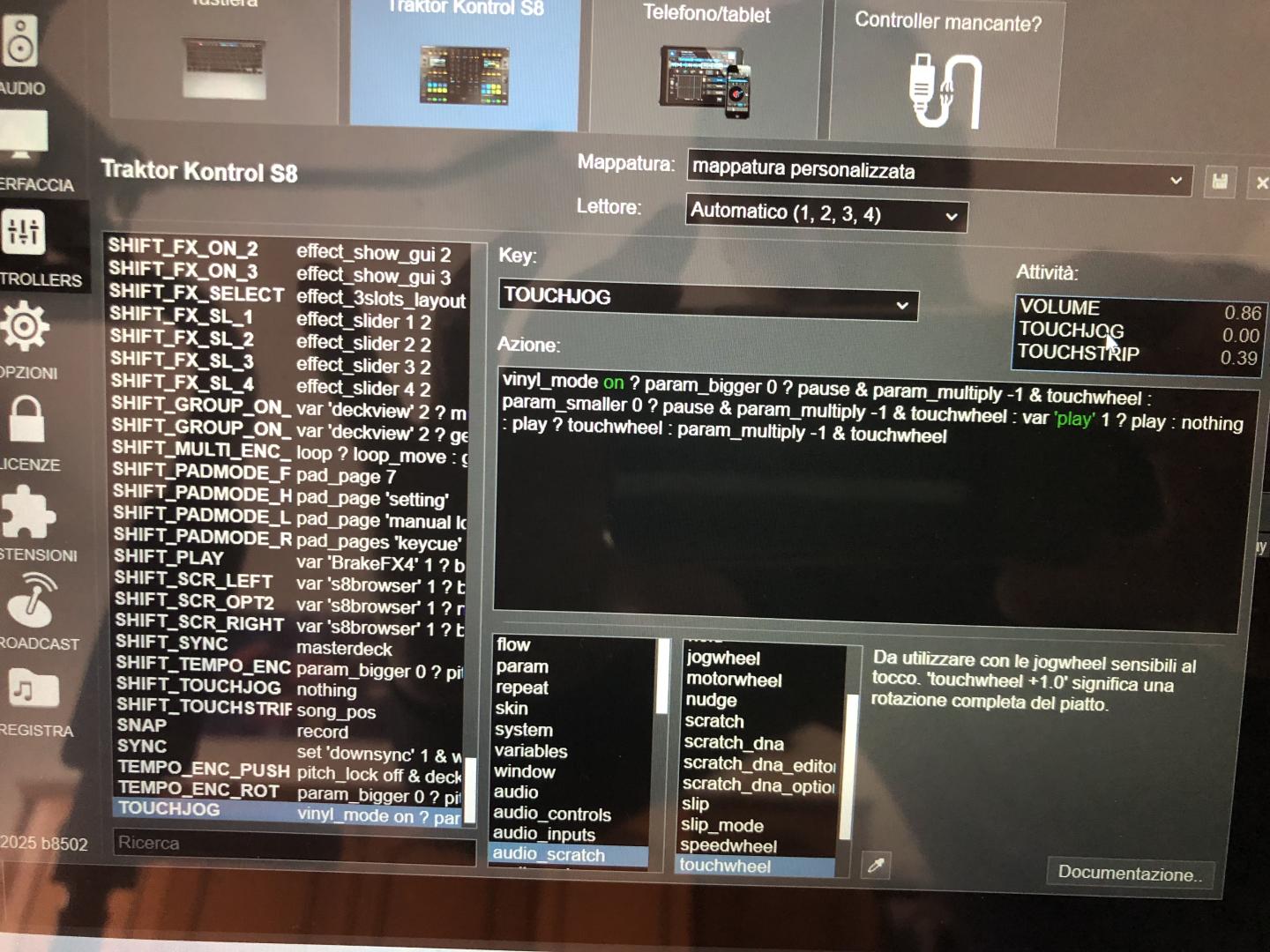

hi! i have slip problem with this script; this script is Kontrol S8 TOUCHJOG modofied about me for scratch, and it works, but with slip on…slip don’t work :( could you help me? thanks!!
