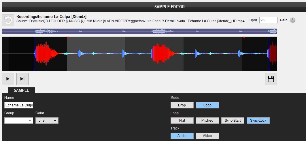

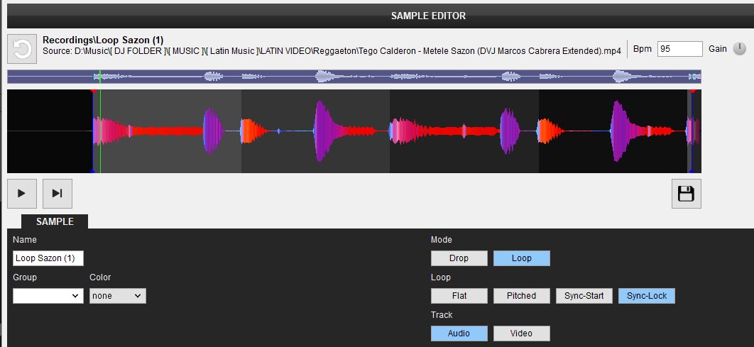

ok i seem to have found out how to make them work ( i think)
and it involves moving around the red handles in the sampler until it sounds right.
i believed that the red handles should be on-beat. but it seems as though i have to move them somewhere in the middle between the beats to get the loop to line up.
i have no idea why this is, i cant get my head around this and id appreciate if someone would like to educate me on why exactly that works.
below are two images, the first one is a loop that just wont line up , ever, when im mixing, but to me, looks perfect in the sample editor.
the second image, is a loop that lines up perfectly well, when in mixing, as seen in the image, the red handles are kind of in no-mans-land.
Posted Fri 09 Mar 18 @ 9:39 pm

It looks like there is a bug in the sample editor in case the sample has the start cut off (as can be seen by the blue triangle not being at the beginning of the sample)
In this case the beat indicator (red triangle) will be displayed incorrectly as being a little too far to the right. (depending on the amount cut off at the start)
If the beat grid of the original file was correct, and the loop is then recorded from that file, the actual file should be correct (and loop correctly), but the sample editor might display the beat grid incorrectly as can be seen on your screenshots.
This will be fixed in the next update.
great, im glad im not going crazy :)
