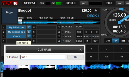

Right-clicking works in some skins, like Controller HD By DennYo
That also let you show it on the screen instead of track times, by toggling "Cue info" in the skin dropdown

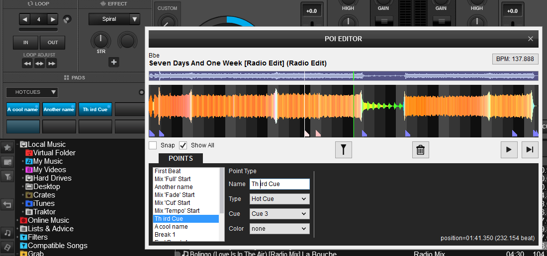

In the VDJ default skin right click on a hot cue on the pad page removes the cue.
Instead you can right-click the track waveform, and change the cue name in the POI editor - or by going to the POI editor using the little dot menu in the pads section
You can then change the cue display to be names in the same dot menu

Then use another skin. Like the Controller HD by DennYo skin, where you simply right click to change:
