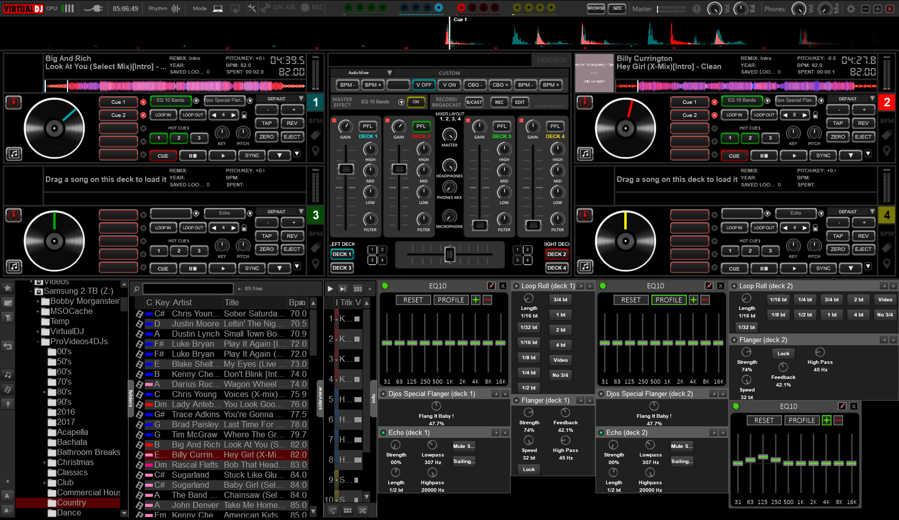

I have a Deck 1 and Deck 2 10 Band EQ that starts in the ONINIT. Although resetEqOnLoad is set to NO my EQs are resetting to flat when I exit the track.
Please!!! What code do I need to put into my ONINIT to keep EQs set where I have them ?

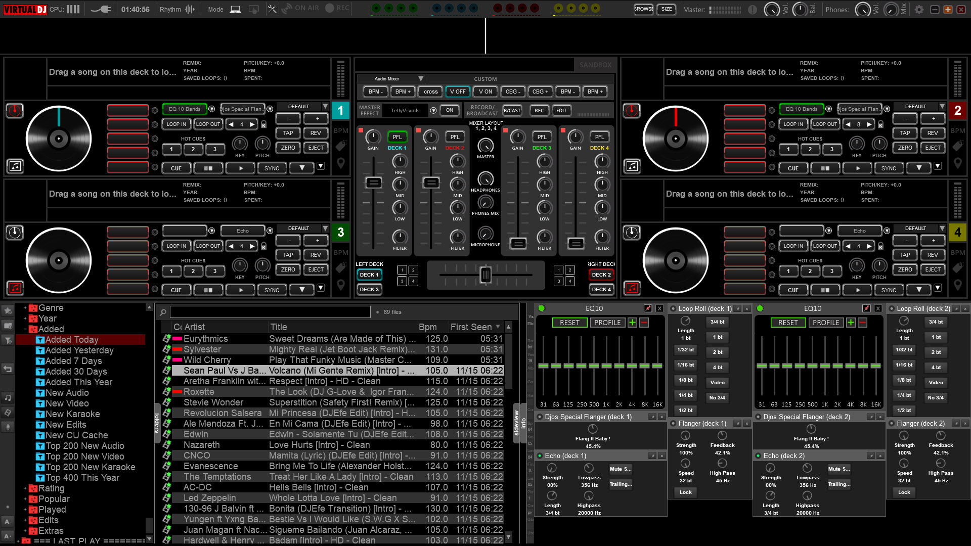

On my skin I have a "Master Effect" section above the Deck 1 and Deck 2 volume sliders. I load in "EQ 10 Bands" and simply turn it on. If I right click it the EQ is put on my skin. Right click it again and it stays on, but disappears from the skin. See below compared to my skin shown above in this thread.
