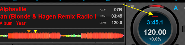

is not nothing special.. here is my code which shows the colored rect you see inside the jog..
The visibility is just a variable i use from a menu. You can skip that.
you can also use the same action for texts, inside the color="" attribute.
<visual type="color" source="get_loaded_song 'color'" visibility="var '@$showtrackcolor' 1" >
<size width="20" height="3"/>
<pos x="+38+35" y="+41"/>
</visual>
<textzone >
<size width="327-78+55+22" height="24"/>
<pos x="+10+78" y="+11+24"/>
<up x="+0" y="+0"/>
<text size="24" color="`get_loaded_song 'color' 'white'`" weight="bold" action="get_title"/>
</textzone>
