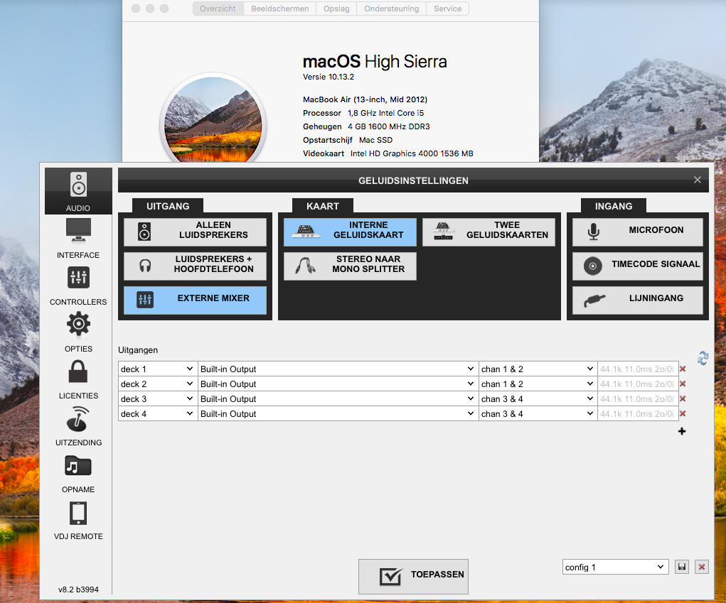

Hi all,
I have been using DJC.4 for ages now but the sound card does not show in audio settings anymore enabling me to mix.
I'm running on Mac High Sierra version 10.13.2
It used to show up as a seperate sound card but no longer.
I can use the mixer but cannot use it like i should be able to.
Anybody else had issues like this & how did you solve it?
Cheers
Cheers

If you click to show the available sound cards in VDJ Audio setup, do you get the Stanton as an option or just the Built-in ?
In MacOS Siera (10.12) i see the DJC-4 in Audio Setup here and the special button in VDJ Audio setup as well. If thats not the case for you, then either the unit is not compatible with the new OSX or perhaps some issue with the connection to the USB port.. USB 3.0 or the new Mac type ?
Since the unit doesnt have any drivers for Mac to install, it relies on the OS to properly see the unit and use internal drivers, so probably a compatibility issue that Stanton needs to address.
If the sound card is available in the drop-down list - even if the special DJC-4 butto is not there - you should apply a Master & Headphones audio setup (not deck ,2,3,4 etc as your pic) as per the manual http://www.virtualdj.com/manuals/hardware/stanton/djc4/setup.html The names of the sound card will be different in your case (not ASIO - thats only for Windows), but other than that should be the same.
Posted Thu 18 Jan 18 @ 10:32 am[ selected best answer by Rune (DJ-In-Norway) on Mon 07 Jun 21 @ 11:12 am ]

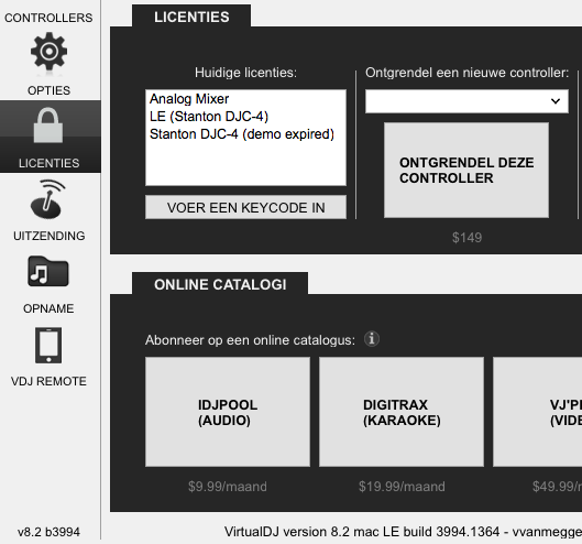

Hi I'have the same problem.
Even when I'm pay for "Analog Mixer" the problem isn't resolved.
I make a call whit the importer off Statnton in Holland. The investigated it...
When I'm now more... I tell you.
Or Vitrutal DJ come whit a update.....!!!

Do you see the Stanton DJC4 as a sound card in Audio Midi Setup (from Applications-->Utilities) ?
