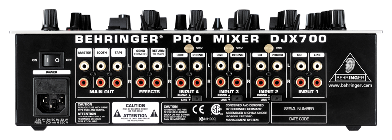

Behringer Mixer DJX700
![](/img/251657/89729/B0002L05ZC-1.jpg)
![](/img/251659/84888/DJX700_P0165_Rear_L.png)

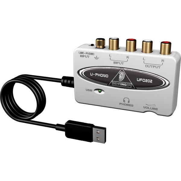

Behringer UFO202
![](/img/251660/91377/248-6506_HR_0.jpg)

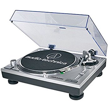

(2) Audio Technica AT-LP120 USB- Direct Drive
![](/img/251661/79802/414jzHHWzpL._SL500_AC_SS350_.jpg)

Thats everything that I have. My issue is I connected it so many different ways and researched how to connect it. I cannot find a solution. I also need help with the audio configurations on Virtual DJ so I can use it. I see several people say that I have to have everything (including the turntables) in line, I also see people saying that it has to be in phono.
I am so confused and would really like if somebody can link me or help me how to set it up and how to configure everything in VDJ 8.
There is a phono/line switch on the turntables, phone/line switch on the mixer, and a phono/line switch on the Behringer USB interface. Is there anything else I need? Anything Im missing? Im starting to regret switching to Timecodes, but I already invested so much money in it, I want to make sure I can do everything correctly.

You can use the usb cable for time-code. You have two turntables, so two usb cables into the computer.
(Don't know if it works for LE-user)
Ps: I just see that the internal usb-audio in the turntables is to slow for dj-ing.
Thanks for your input.
That basically mean that it is not a good idea to connect the timecodes through USB with the turntables, correct?
Posted Fri 29 Dec 17 @ 7:24 am
You've got everything required, except a suitable audio interface.
If you have two turntables then you will need an audio interface with two stereo inputs and two stereo outputs. The Behringer only has one of each.
Best to buy one designed for the job ("right tools" and all that). Denon DS1, Pioneer DJ Interface 2 or similar.
