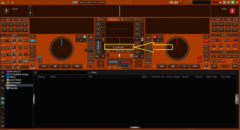

But I still having problem with saving effects in the videosection (picture above), its gone when I restart.
Could you please try to solve this !?

There is only one specific video effect slot.
I'm guessing that the skin uses additional regular effect slots there, possibly slots higher than 5.

If there are already 4 master effects as well, there are not enough automatically saved slots left anyway to have both 4 for video and 4 for master. At best they could be organized differently so that at least the first 3 would be saved.
For the others you would currently have to use an ONINIT script instead, since there's no immediate plan to store more effects in settings automatically. (Since they could cause a bad skin or script to select many effects in many slots that you may not be using anyway)
