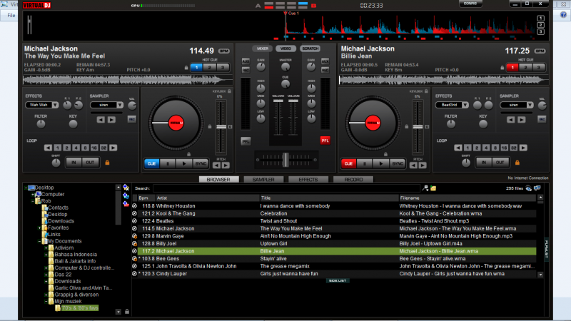

Thanks, I'll give that a try and let you know whether it works. The skin I'm referring to is the default 2-deck skin:
