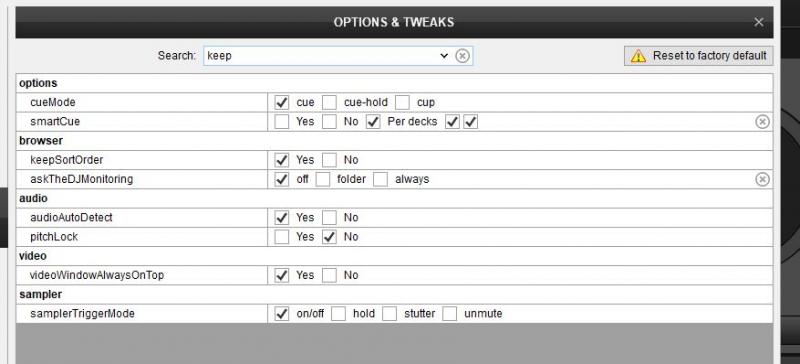

Can't seem to find the option you mention, Adion ...
I'm on build 3798.
I got the update recent but not using it yet.
Didn't see any mention of 'keepBPM' option being added in the ChangeLog of the update
I'm on build 3798.
Posted Tue 22 Aug 17 @ 7:00 pm
that feature was added to this build

aha ! it seemed to be added in the 'early access' build 3846, so will be in standard build 3848.
Will use the update build 3848 right away ! :-)
