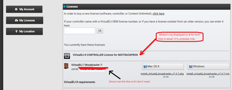

It seems like every time I open VDJ, it asks me to download updates or upgrade. I typically accept because it magically starts locking up mid-set when I don't. Typically there is no problem. However, today, after doing the latest update, it's telling me that the license for my controller is no good.
At one point, it tells me that my license is for V7.
However, in the My licenses tab it clearly shows that I have a "VirtualDJ 8 CONTROLLER License for MIXTRACKPROII." Also, it displays my old VDJ 7 license but won't display my license for the "VirtualDJ 8 CONTROLLER License for MIXTRACKPROI"
Why should I have to pay for the controller license because your pop-ups harass me into upgrading?
So is VDJ going to force me to pay for a new license fee to use my controller every time there is a software update? If so, I'll go ahead an jump ship to software that other DJs have been using instead.

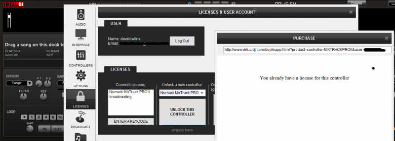

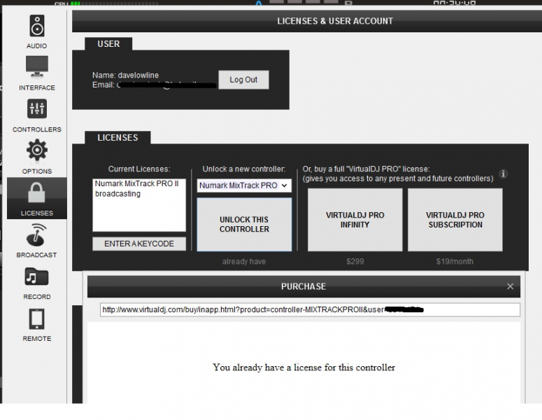

it gets better. It's now telling me I already have the license but wont let me use it. I'm open to suggestions or a response from customer service.

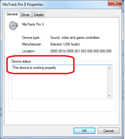

Does your controller stop working?

The only lic# that shows up in my "MY LICENSES" Tab is the lic # for VDJ 7. But it will not show me the Lic for VDJ 8 controller license. But of course it will not work without me re-entering the controller lic# that I cannot attain through my "My License" tab.
However, as shown above, it clearly detects that I have the license when I am signed in.

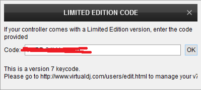

I think I was getting this error message because I was trying the old Lic# from V7. However, you can clearly see that I have V8 Controller License.

VirtualDJ 8 does not require license numbers.
If you are logged in in VDJ 8, and it shows your license in the Config->License tab, then everything is fine.

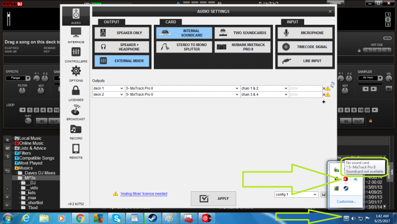

The controller is not working with VDJ 8. Control Panel indicates that it is working. But, once I open VDJ 8, I get the Error Message that it is not working and then clicking on the error ICONs indicates I have a License Issue.

Once I click on the Error Icons, it the POP-UP indicates that I have a License Issue.

In the audio tab, click the big 'Numark Mixtrack Pro II' button at the top to set the audio config to the correct configuration.
Edit: The reason you get the license popup is because the audio setup is not correct for this controller.

That worked.
But this all had nothing to do with Licensing.
Would VDJ consider a pop-up indicating a problem with audio config as the problem vs. the License Issue? I just wasted 3 hours on this when I typically only have about 2 hours a week to even practice DJing.
Also, I had no issues with audio config before I did the recommended software update.

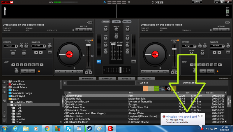

The first popup does say 'soundcard not available', which is what the actual problem was.
(It can happen when switching usb ports for example that the name slightly changes, for example the '5 - ' that you see at the beginning of the name in your first screenshot may have changed to '6 - ')
The problem is that at that point vdj can't tell if the no-longer-available name belongs to the controller that you have a license for, and that's why you get the license message for analog mixer.

After you have selected the correct sound config, in the bottom right hand corner of the sound card config, type the name in the drop down, and hit the little save button next to it.
Sometimes, the software will revert to the default sound card, when it updates, and your controller is not connected. You have to make sure that your soundcard is selected. Glad it worked out for you.

You chose a sound setup for an analog mixer, which requires an analog mixer licence.
That's what VDJ tried to tell you.
