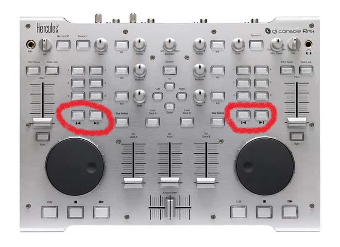

Can I map these buttons on my RMX

Sure
See here if you didn't change mappings before:
http://www.virtualdj.com/manuals/virtualdj8/settings/controllers.html
