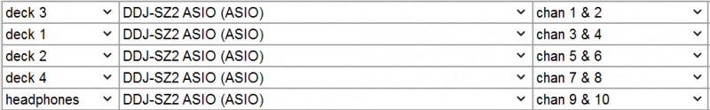

this is my audio output settings.
note: ch1-2 is deck 3 not 1
it starts with deck 3,1,2,4 not 1,2,3,4.
i don't know about recording.. audio input.. just audio output.

and for the audio settings I have them I this order:
deck 3
deck 1
deck 2
deck 4
headphones
is it correct?
Posted Fri 21 Jul 17 @ 2:18 pm
blacknoiz wrote :
is it correct?
Did you look in the manual that PhantomDeejay mentioned?
Please compare your settings to the ones in the manual (that are applied by default when you press the big DDJ-SZ2 config button).
Posted Fri 21 Jul 17 @ 3:25 pm

Check your audio settings then. The 3 of the 4 Color FX are HARDWARE operated, and they should function properly if you have the correct audio settings!
If they don't work this means you have WRONG audio channel adjustments.
The correct audio settings are posted on the manual...
In fact, ALL your questions are answered on the on-line manual, on the Troubleshooting-FAQ chapter:
http://www.virtualdj.com/manuals/hardware/pioneer/ddjsz2/troubleshooting.html
