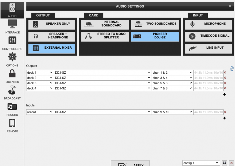

In VDJ soundcard settings, how does your selected device appear?
Posted Thu 09 Mar 17 @ 11:11 pm
pioneer ddjsz i just click it and press apply will set it all back tomorrow and take a screen shot thanks
Posted Thu 09 Mar 17 @ 11:15 pm
Here is a screenshot
