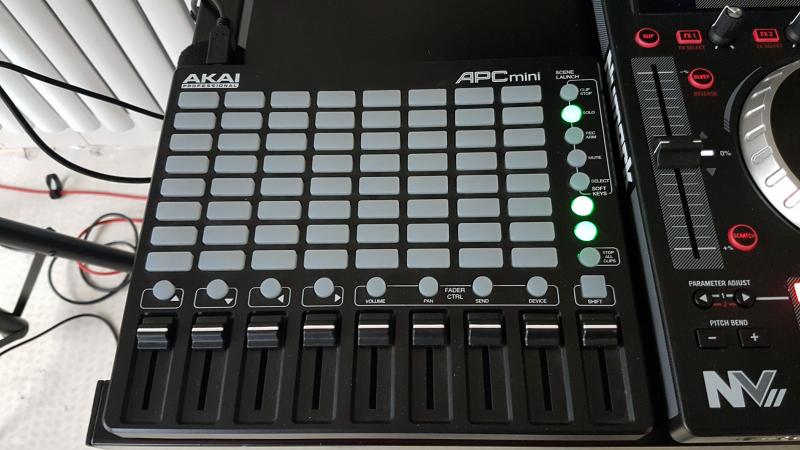

Have a weird issue as of this morning. On my APC Mini the buttons are no longer coloured. They still show as coloured on the sampler side panel in the skin, but not on the actual unit. If I change the mapping back to default, then they all turn yellow, even though they are coloured all different colours. Worked fine until this morning. I did enable early access couple of days ago, but other than that I have not changed anything. Anyone else got this problem? I know quite a few people run this unit. It still works fine and when i press a sample it then lights with the right colour.

Appreciate the reply. I always have everything connected before i even start the laptop. I have restarted the laptop a few times and not changed anything. I just tried unplugging the APC with VDJ open and reconnecting, but still the same. I have not changed any other hardware. I just run this unit and a Numark NVII Have tried different cables and USB ports. Its very odd, but I also have an issue this morning with laptop not detecting HDMI monitor. I doubt its related but its odd I have both issues this morning. I am runnig a 6 month old Asus Rog with top end specs.

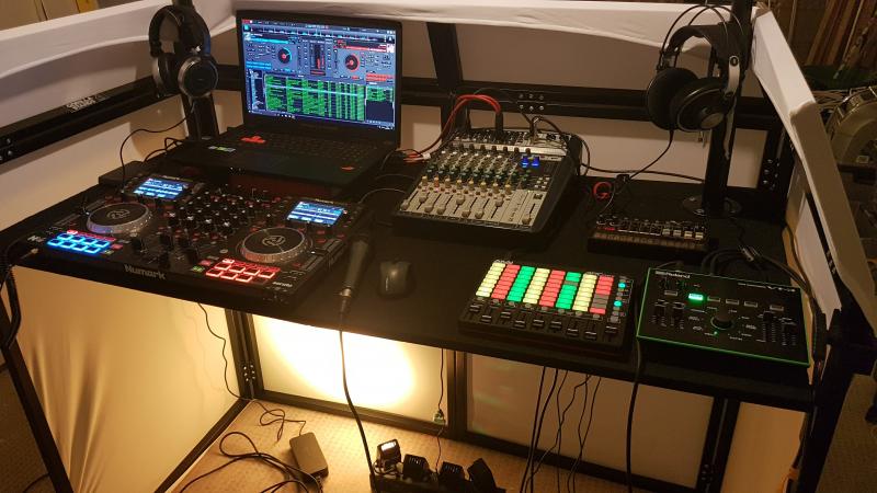

This is how the unit should look. I have not changed any mapping to these buttons, the only custom mapping i did was to map a few buttons which were blank. If i load the factory default mapping, all the buttons are yellow. This is how it has always been, for the last six months I have had it. The leds blink when playing and are static when not, but at least i can see from the colours what is what and which buttons have a sample on them when i dont have the window open on the skin. Now they dont light up until i press them
