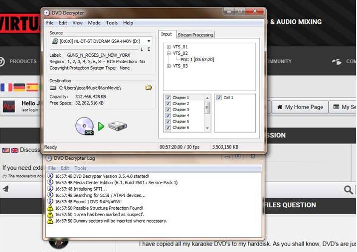

hi, if you use the DVDdecryptr, you must use the filecorrection, is IFO MODE, then each song will rip in individual vob file for each track, as mentioned above,
hope it helps
GK
hope it helps
GK
Posted Thu 02 Feb 17 @ 12:31 am

So a plan could be to rip the dvd using DVDdecryptor to individual song vob files, and then convert them all to mp4 using WinFF. Just 2 steps to create a lot of songs. That's if it works?
Posted Thu 02 Feb 17 @ 1:29 am
This plan works.
I saw a couple of problems.
1. DVDdecryptor hung on exiting, that did not cause a real problem.
2. The mp4 presets in WinFF are very poor. As a temporary measure I used my own xvid setting using 320kb/s mp3 audio. That worked. Hm.. we only need one quality video audio preset for mp4.
DVDdecryptor was a star.
So..yes it all looks promising!
Posted Thu 02 Feb 17 @ 4:34 pm
