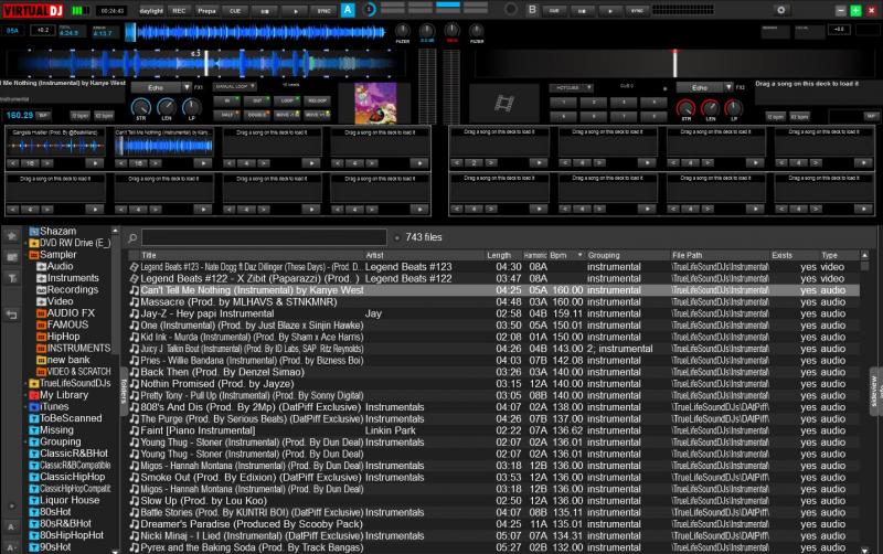

Ok I have a question is there a way to use te pads to trigger the mini decks? Ive tried every thing

Sure. I pm the skin...but the skin will change, we are trying to have 8 decks in 4x4 to match pads

OK the guy i was working with has decided he doesnt want to finish the skin, he is trying to talk me threw it but it just not working, would anyone like to help me complete the skin. Its only 2 steps left

Adding Rec to each deck to capture loop and load it to that remix deck, Add a button to bring selected minideck into focus. Master deck select. These were in previous builds but my partner quit before adding them to the latest build. So i have examples but after trying i cant get them correct.
Posted Sat 31 Dec 16 @ 11:38 am
The recording thing sounds a little awkward because you can't record to a deck. Recording can only be made to the sample folder or to a sample pad/slot. So I guess you'd have to record it to a sample, then have that sample load itself after it's been recorded.
Posted Sat 31 Dec 16 @ 12:00 pm
can a script be written that once the sample is made its load to the same deck where i pressed rec?
