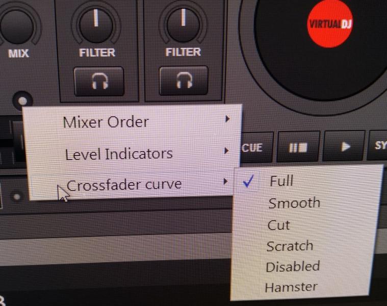

the current skin i use (which is one of my favs & really the only one i use) it does not have an option to adjust the Crossfader Curve...
everytyme i get to a gig i have to select the default skin & click the lil button above the fader & then select Smooth
no my current controller Denon Mc4000 dows not have an adjustment curve ;-) is there any setting / shortcut so i dont keep having to load up the default skin & then select mines at every gig ?
everytyme i get to a gig i have to select the default skin & click the lil button above the fader & then select Smoothno my current controller Denon Mc4000 dows not have an adjustment curve ;-) is there any setting / shortcut so i dont keep having to load up the default skin & then select mines at every gig ?

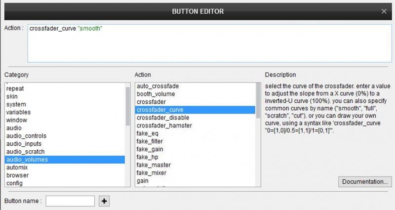

Just assign a custom button.

Seriously i can't even find the button you speak of, is this the default skin?
Posted Tue 15 Nov 16 @ 8:03 am
The Mixer Options menu is available in the 4 Decks Default skin, right above the Audio Crossfader
Posted Tue 15 Nov 16 @ 10:18 am
Ah! only in 4 deck mode, got ya. Thanks
But u only have load up the 4deck skin...make the change then go back to your 2deck skin of your choice its what I do B4 every gig
