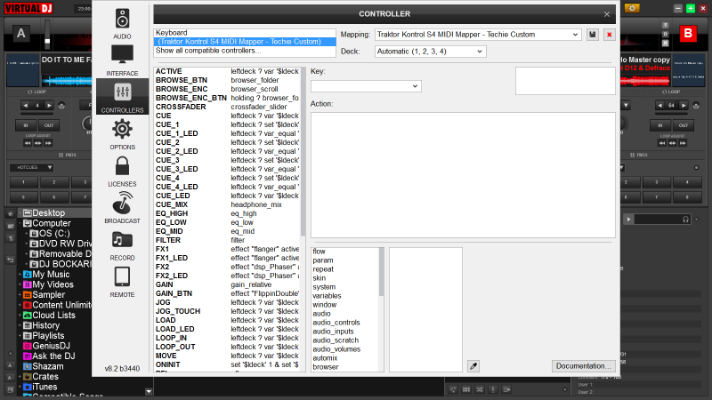

Hey Guys,
here is the Screenshot of both my VDJ 8 Audio and controller settings. I have been trying to setup my Kontrol S4 mk1 to work with VDJ 8 using the mapping from this site. any help is appreciated. Thanks again for your help.

Yep entirely wrong audio config
You want SPEAKER HEADPHONES
with
master S4 1 & 2
and
Headphones S4 monitor 1 & 2

Thanks for you help. I changed the settings per your advised. In VDJ 8, when you select Master from the Output, and the Kontrol S4 (ASIO), you only have options for Out Master left & right. The same for Headphones. There's no option for "master S4 1 & 2
and Headphones S4 monitor 1 & 2", however, it now works, just have to play with it to figure out how to set cue points using the controller. Thanks again, if you have and other tips or how this mapping work with this controller please let me know.
