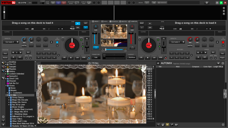

If I load a 4x3 music video and use Telly Media to play a 16x9 clip over top of the video, VDJ resizes the Video effect to fit a 4x3 window.
No music video loaded. This should and does fill the full 16x9 main output window.

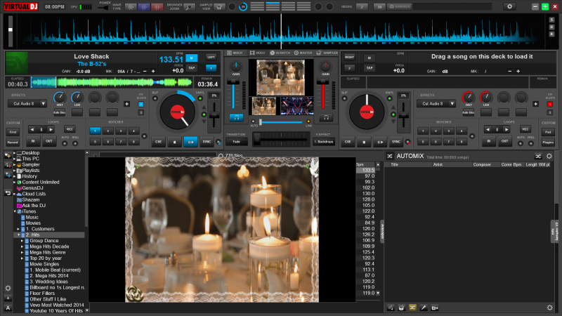

Here I loaded "Love Shack" which is a 4x3 video. You can see my 1920 x 1080 Video and 1920 x 1080 boarder resized to fit inside the 4x3 aspect ratio and black boarders on the side. The main output Aspect ratio of VDJ should not be limited or changed by the size of the video loaded in the deck.

The main aspect ratio is not limited. You can change the aspect ratio using the letterBox option.
As for effects, they will be applied to the source.
If the effect is selected on the deck it will apply to the deck in the decks aspect ratio.
If you select the effect on the master output it will be applied to the master output, so in the aspect ratio of the video window.

I did not notice that this effect was applied to a deck. I had the script " effect_active "TellyMedia" ". I was not intentionally going for deck loading. Everything I do with effects work best on the Master output.
" deck master effect_active "TellyMedia" " fixes everything for my purposes. Thanks again Adion!
