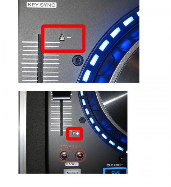

2.https://vid.me/lA9Y now blik only the first led
3. i mean this led
3. i mean this led
Posted Mon 21 Nov 16 @ 7:01 pm
The arrow LEDs are "hardware" controlled. They cannot be mapped.
The pitch fader itself is also acting a bit hardware-ish, meaning that if you move the pitch fader and swap decks, the fader doesnt report/send any MIDI to the computer until it reaches the pitch hardware value of the deck.
Posted Mon 21 Nov 16 @ 9:30 pm
